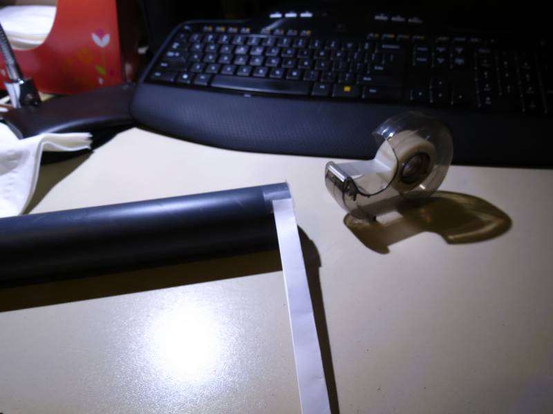

I started with a strip of paper taped to a plastic tube (substitute for the collar).
[ATTACH]21402[/ATTACH]

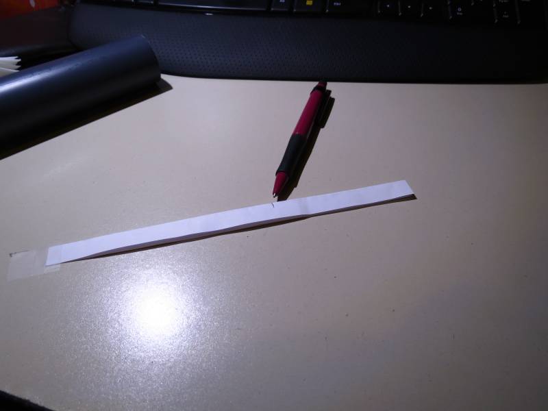

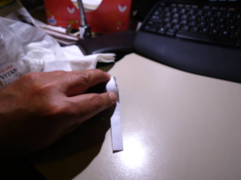

I then wrapped the paper around the tube so I could mark the length or circumference.
[ATTACH]21403[/ATTACH]
The length is from the edge of the strip to the mark and I really could care less how long that distance is.
[ATTACH]21405[/ATTACH]

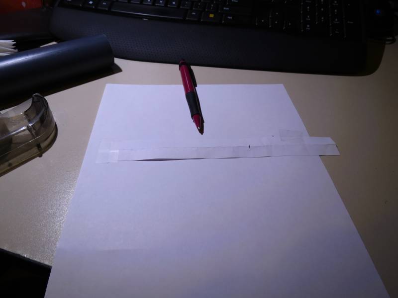

I then attached the strip to a sheet of paper, you will see why in a moment.
[ATTACH]21406[/ATTACH]

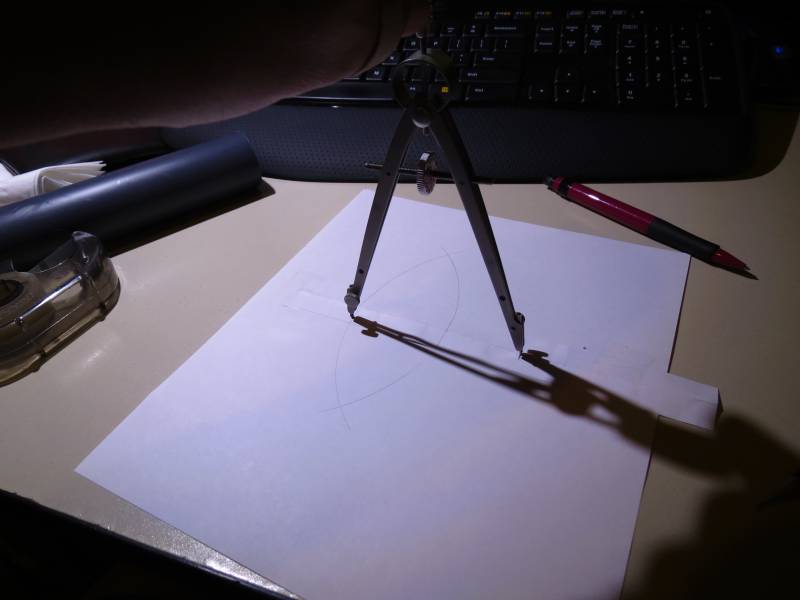

Remember way back in school when you learned to bisect a line? That is what we are going to use to establish the markings. I started by using the two end points and finding the center. If a full revolution is 1/16" then a half will be 1/32".
[ATTACH]21407[/ATTACH]
More coming.
