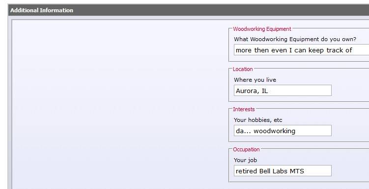

Hey bill, I've tried several times to add my location to my profile to no avail. The error message is in the area of woodworking. When I input woodworking it says invalid value. What gives??
godavid2 wrote:Hey bill, I've tried several times to add my location to my profile to no avail. The error message is in the area of woodworking. When I input woodworking it says invalid value. What gives??
Put in something besides wood working.:rolleyes:
Are you going to UserCP
then
Edit Profile
at the bottom it should look like this:
[ATTACH]21430[/ATTACH]
Make your changes and click on "Save Changes".
That should do it.
