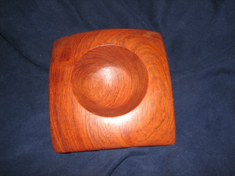

Interesting about the Ulu. I also had never heard of that and went to the web site that was shared and gained some knowledge. I have never tried to hollow out a bowl like indentation with the table saw but I did turn a square bowl on a lathe. The challenging part on turning that piece was not getting close to the square edges which you could not see while it was turning. Attaching a picture of what it looks like. Also I did a couple of Windsor chairs hollowing out the seat using an aze, spokeshave for the bottom of the seat and a gouge for smoothing out the seat to a level where I sanded the remaining roughness smooth. If you check out my profile you will see one of the chairs I am talking about. Seeing that I have done both of these methods, it is doable. I noted in the Ulu web site that they make their product from Alaskan Birch and Walnut. Looking forward to seeing your finished product.
- Square Bowl 1.jpg (173.73 KiB) Viewed 13474 times
- Square Bowl 2.jpg (179.75 KiB) Viewed 13465 times
