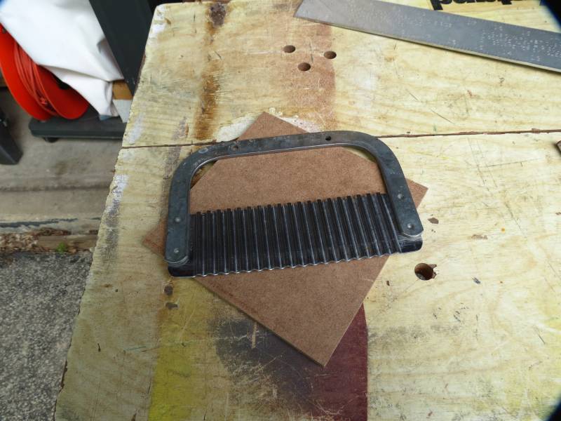

My wife has this old chopping thing that looks like this
[ATTACH]21614[/ATTACH]

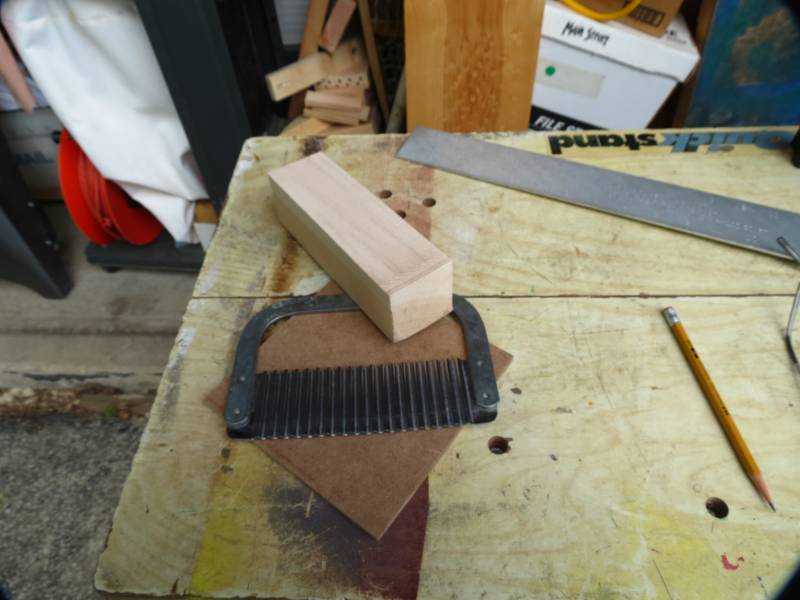

She has requested that I handle it. I had picked up some sycamore a while back for several projects, including this one. I've never worked with sycamore and I'd also read that it might be a good wood for the projects, so no time like the present to have a go at it.
I had cut off a chunk of the wood and set it aside until the time was right to get going on the project.

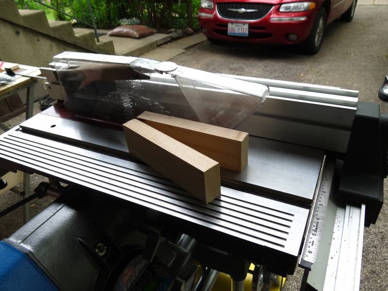

Since the handle was going to wrap around the cutter I cut the blank in half and squared the ruff cut after taping the two halves back together.

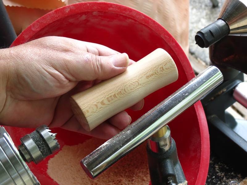

I decided to just turn the square rather then "octagoning" it. Went with the stubs like drive and a cup live center so it would be more secure and less likely to split in a catch. Turns out there was no catch and it turned fine.
[ATTACH]21617[/ATTACH]
This is as far as I've gotten and I'm done for the day. Weather permitting I should be back at it tomorrow.

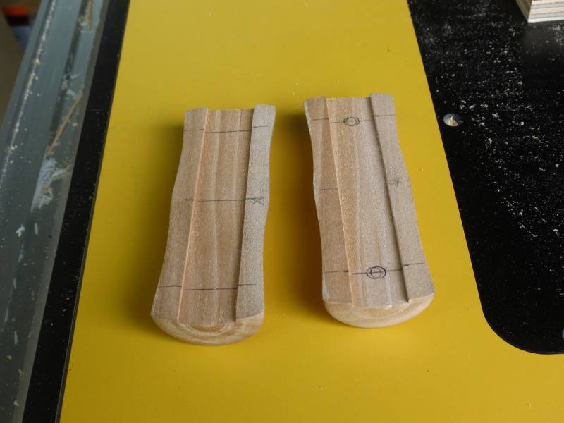

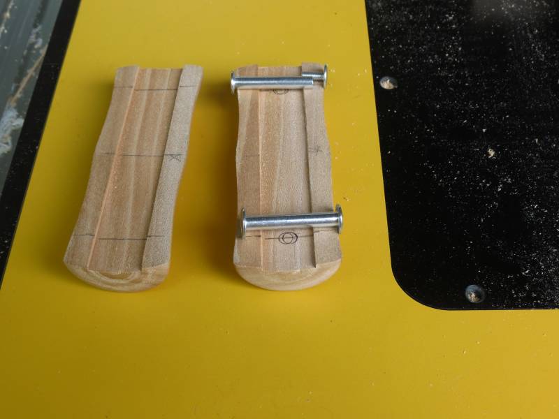

Split it in half again and then routed out the center to fit the chopper, a little on one side a little on the other.
[ATTACH]21631[/ATTACH]

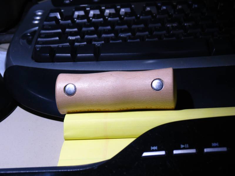

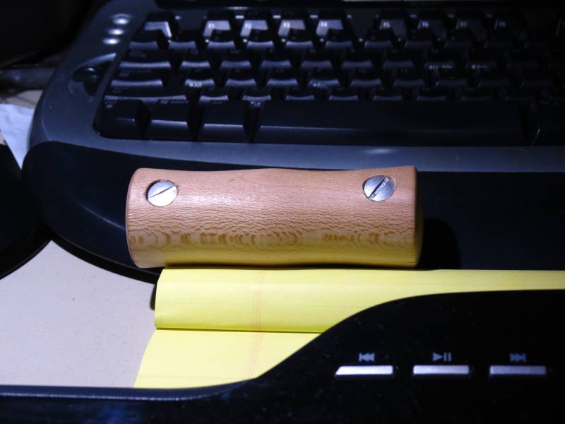

The hardware looks like this.
[ATTACH]21632[/ATTACH]
One side is plane, the other has the screw slots.
[ATTACH]21633[/ATTACH]
[ATTACH]21634[/ATTACH]
This is where I stopped today. Hope to get back on it in a day or two.
