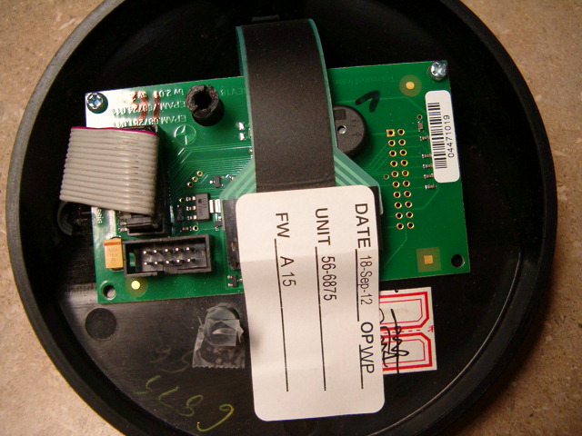

Back of the control unit. The two plastic screw posts broke off. Maybe they were tightened too much. I had put scotch tape on the lower post to hold the pieces together.
[ATTACH]21673[/ATTACH]

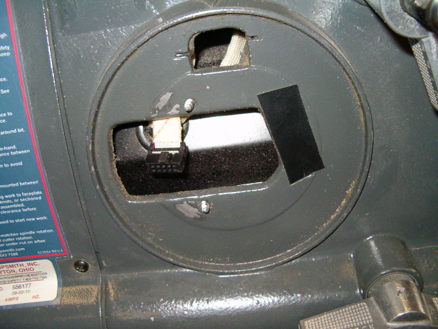

This is where the control came from - Notice the two screws are still in the case. There wasn't enough room inside to remove them.
[ATTACH]21674[/ATTACH]

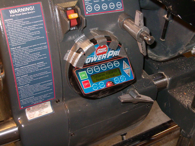

This is how I operated for a week while waiting for the new unit.
[ATTACH]21675[/ATTACH]

I noticed the two holes to accept the control unit screws were originally used to attach the speed control bracket. They still had threads in the holes that caused the new screws to bind. I'm thinking the binding caused crooked installation and stripping of the plastic holes. Anyway, I reamed out those holes in the headstock case before installing the new unit.
