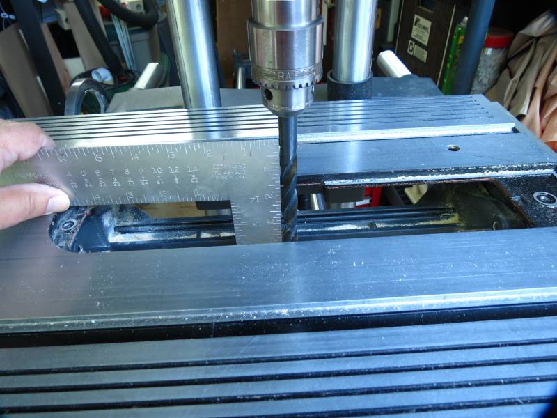

Step one is to make sure all the locks are locked, the table is tipped so it is against the stops and locked in place.
I started with a know straight 1/2" drill bit chucked up. I pulled out the table insert and took off the lower shield. I then check using my square as shown.
[ATTACH]21764[/ATTACH]
I didn't expect any issues and there were none.

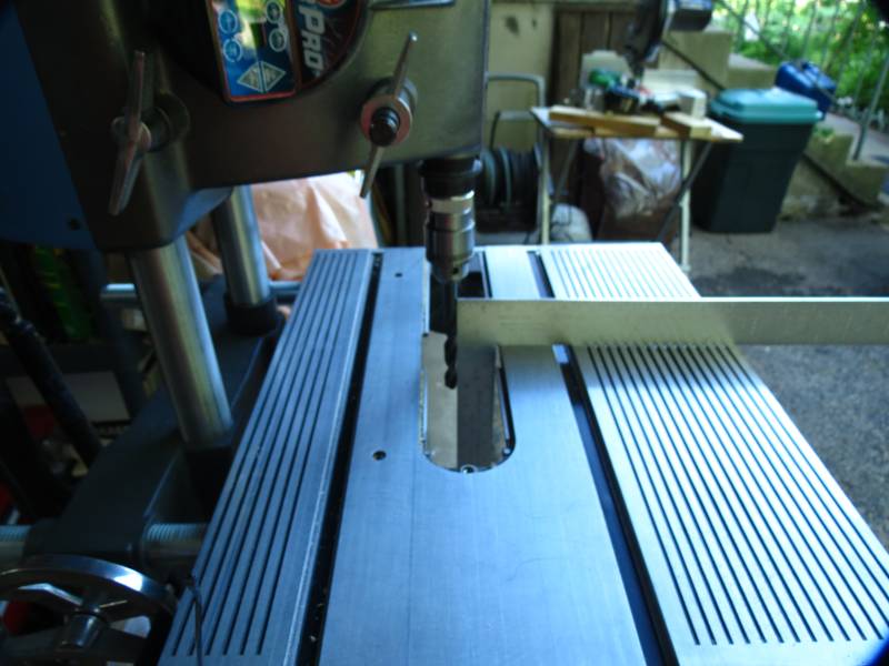

Next I checked the other axis, again things are right on.
[ATTACH]21765[/ATTACH]
So no changes required for the leg swap, well at least in my case.
Keep in mind you can not use the table insert as a reference surface, best to just get it out of the way.
