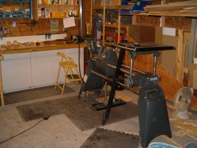

Happy that trick worked for you!:D I don't do much turning so don't have that issue, but have floor pads I bought for foot comfort. Think they are easily available. I like them when lowering the heavy end of the Shopsmith after moving it. Here's what they look like.
[ATTACH]21839[/ATTACH]
- shop_innards.jpg (133.01 KiB) Viewed 2948 times

I thought about bigger / heavier floor pads. But I didn't want to lift up my unit every time I move it on to the pad. I agree about not liking that clunking sound when lowering the heavy end. I would love to be able to put industrial rubber floor mats over my entire shop floor but it is a little out of my budget. Hello lotto!!!!
Hi Tex! Gotta tell you - - using standard wheels - the shopsmith will roll onto those pads when the wheels are in their lowest orientation. When rolling on the half low position, the Shopsmith won't go onto the pads without lifting. The pads are 1/2" thick.

Mine were a present from my Son. Think he found them at Harbor Freight, but I couldn't find them in a quick search. mine are 1/2"thick and have a diamond finish top. Like the steel decks and steps on fire trucks. I think HF gets a supply of these every once in awhile. I know I've seen them last year.
Found some that might be the same at Home Depot's site. HDs are pretty expensive, but at least they re the right size (2'X2'). I wouldn't buy from HD without first seeing them.
try to let google find some for you. They are really the cat's meow! I now have six tiles interlocked with straight edges.
