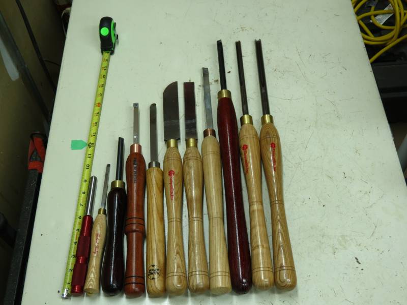

I was looking at the them, since I have a few openings in my collection. I like the carbide cutters and have an Easy Wood Pen Chisel along with some other such tools.
When I looked at the description " With an overall tool length of 12-1/2"....) I realized that these are small tools. No wonder the price looked reasonable.
I took a sampling of my tools and shot a picture to give you a better perspective on their size.
The green tape arrow shows the length of the on special tools. The longer ones on the right are about 22" and are from the shopsmith bowl set. The smaller ones on the left are "micro" tools. If you count over 5 from the left you will find one of the standard tools from shopsmith.
I'm not saying anything is wrong with the special, just make sure you take notices of the size.

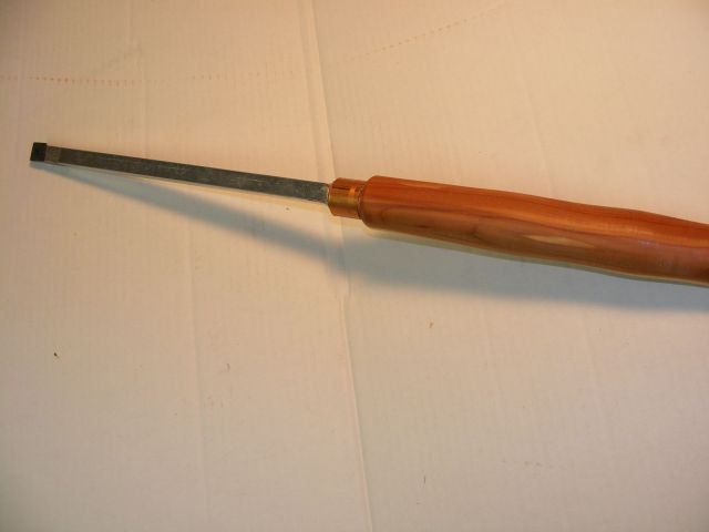

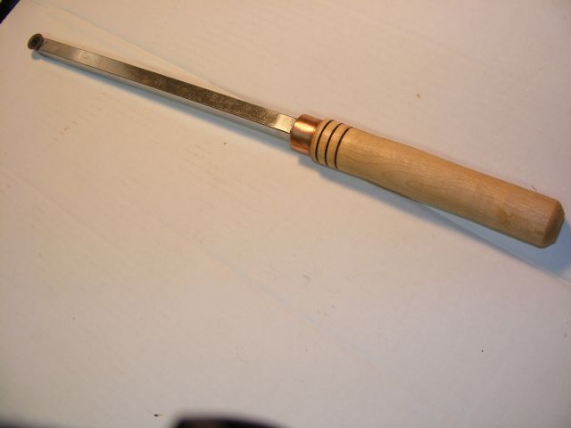

The answer is make your own. Here are two of mine and both are 22" and very heavey duty. One is a round cutter and one is a square cutter. I am working on a diamond shaped. Works great and cost about $30 each to make.

wlhayesmfs wrote:The answer is make your own. Here are two of mine and both are 22" and very heavey duty. One is a round cutter and one is a square cutter. I am working on a diamond shaped. Works great and cost about $30 each to make.
I've been thinking of doing the same thing.....making my own. I've not done a lot of research on a source for the carbide cutters. Would you mind sharing your cutter source?

There a many sources for cutters, I have had good luck on Ebay and I have also just gone to woodcraft and bought the one I want. Also Captain Eddie on line has good buys on them on this site and I have gotten seveal from him He also has youtubes on making some of the tools and can save you a bunch.
http://eddiecastelin.com/
He is good at what he does and is just a good old boy woodturner.

Can you go into more detail. I'd be interested I trying that. In particular how do you attached the carbid cutter to a regular HSS tool?wlhayesmfs wrote:The answer is make your own. Here are two of mine and both are 22" and very heavey duty. One is a round cutter and one is a square cutter. I am working on a diamond shaped. Works great and cost about $30 each to make.
