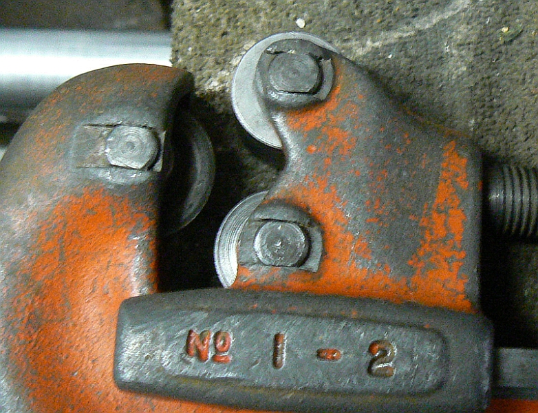

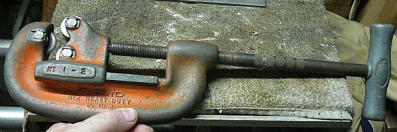

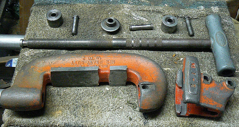

Picked this up at a yard sale for $3. Decided it needed a bit of tlc.
[ATTACH]21905[/ATTACH]

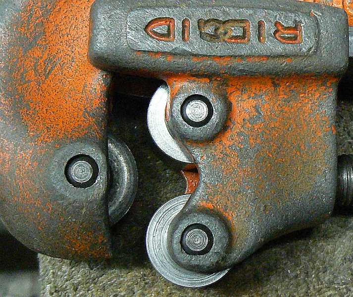

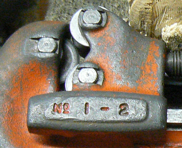

First puzzle is how to remove the rollers and cutter. This side has pins that are aligned to slots. I assume that is to prevent the axles from turning. The heads limit motion toward the body.
[ATTACH]21906[/ATTACH]
From the opposite side, the axles are flush with the outer surface. There is no way to rotate the axles because of the heads and slots on the other side, so I guessed they would press out from this side. Turned out to be a good guess.
[ATTACH]21907[/ATTACH]

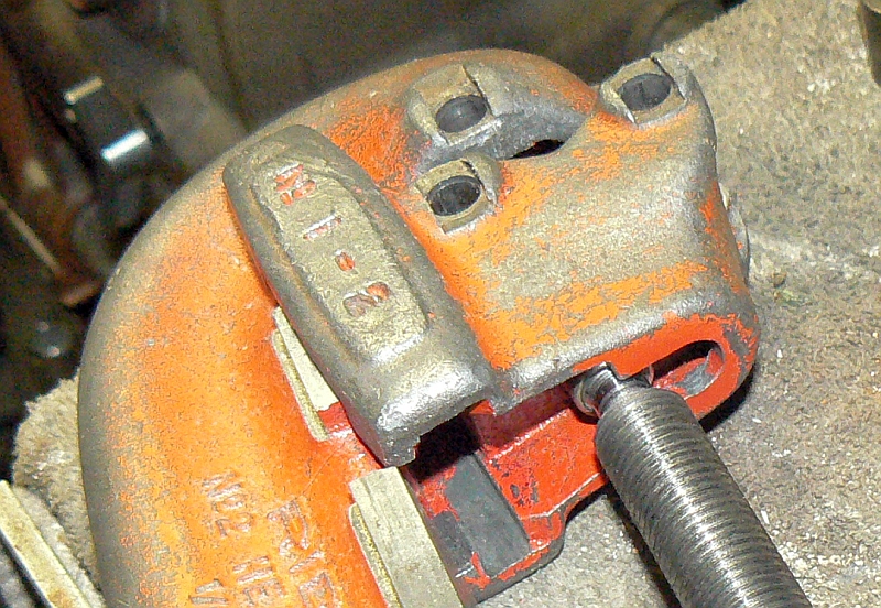

But how does the moving slide come off the main body? The slide is held captive when fully opened and when closed the cutter and rollers interfere.
[ATTACH]21908[/ATTACH]

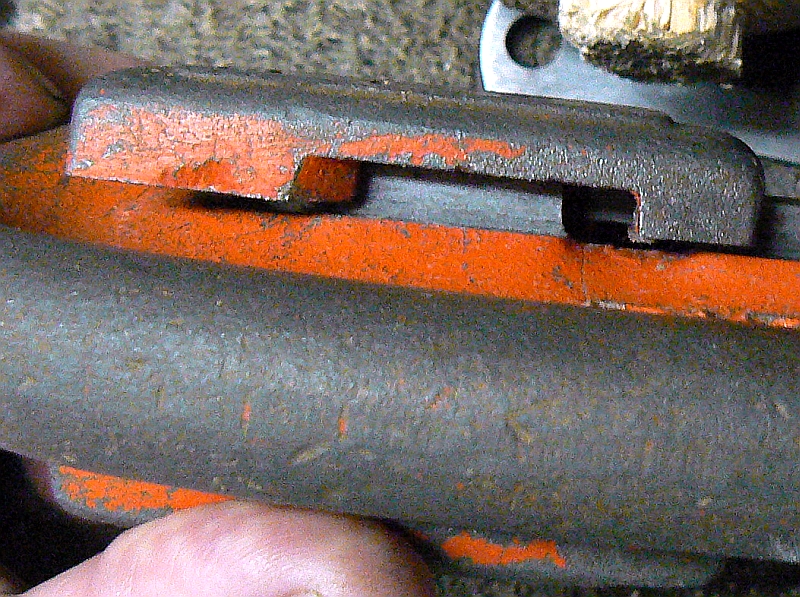

Underneath is a clue. the slide has a notch. The main body where the slide 'slides' also has a open area. Not shown in the pix, but the screw has additional threads at the cutter/roller interference point. If the slide were moved further, the slide notch and the ,main body open area will align.

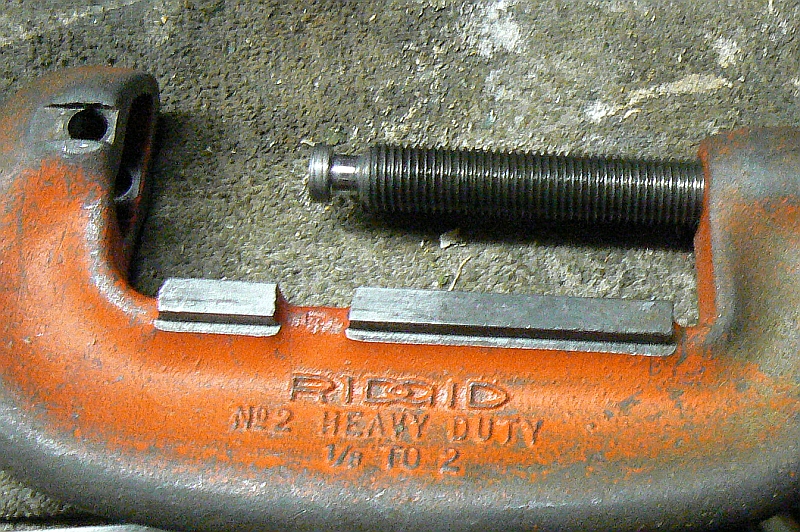

Another clue is the notch the screw goes into the slide. It had to slip on, so it must slip off.
After removing the cutter and roller axles, moving the slide further until the slide notch and main body break align, the slide slips off.
[attach]21910[/attach]
The screw can now be backed out completely since the end is smaller than the thread id.

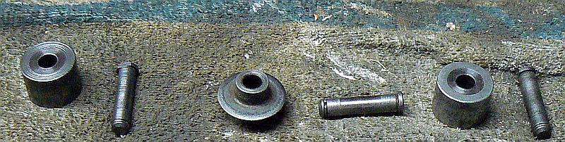

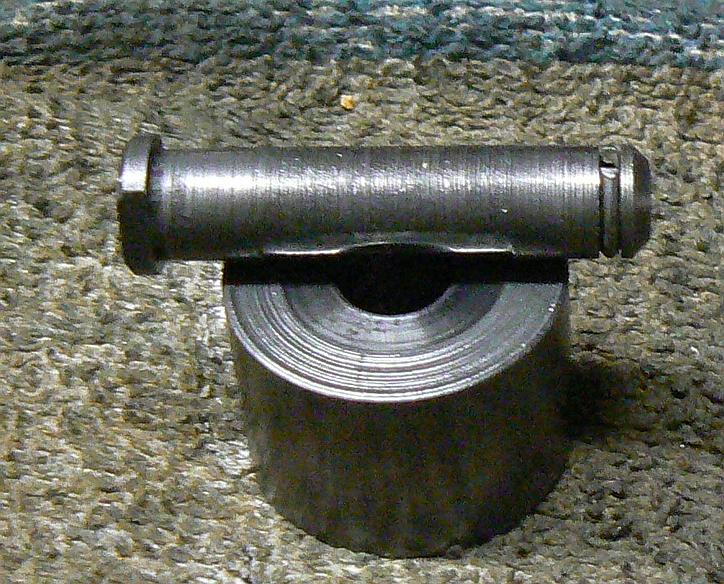

The roller axles were worn on one side only so this is the first time they have been removed. Notice the retaining rings on the axle.
[attach]21912[/attach]
The cutter axle was had wear on both sides of the axle, so the cutter is likely not the original.
[attach]21913[/attach]
Exploded view. Not too many parts.
[attach]21914[/attach]
Reassembly is the reverse. I was able to get a 5 pack of new axles and a new cutter. The current model number is '202' This is a model 2. Wonder how old it is?
I used 3 new axles and decided to use the old cutter for the time being as it looks like it does not have much wear. I am keeping the original axles(the roller axles can be used so that the bearing surface is on the opposite side of the axle).
I applied lithium grease on all moving parts bearing surfaces.
So I spent an additional $20 and have a nearly new condition good quality pipe cutter and some new and used spare parts. Ready for mini making.

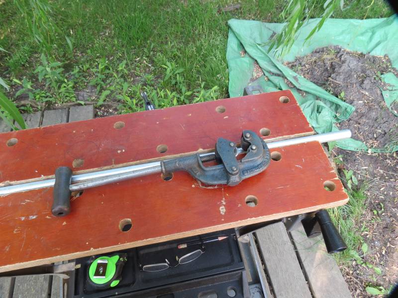

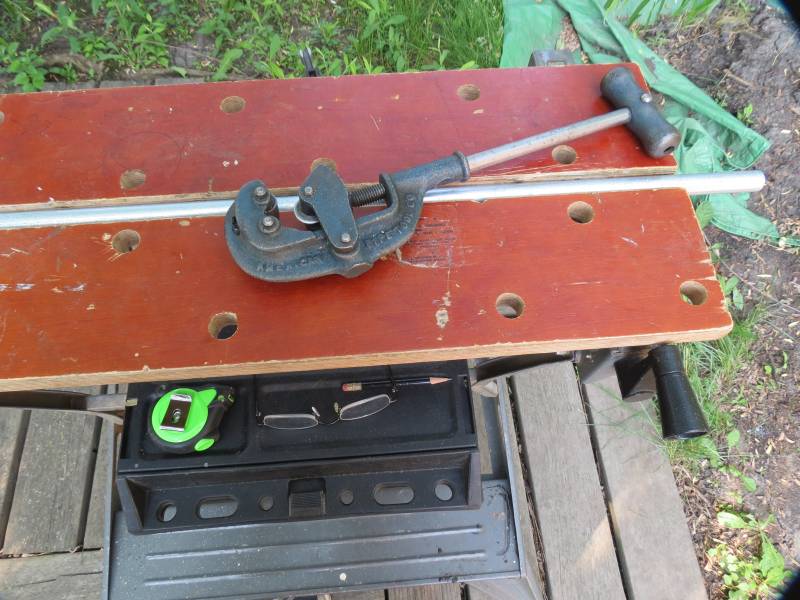

Funny that a pipe cutter happens be be a topic here since I've dug mine out to cut conduit for a couple of none electrical projects just a week or so ago.
This is what mine looks like, and I'd have to say I think it is pretty old just because of how it looks.
[ATTACH]21915[/ATTACH]
[ATTACH]21916[/ATTACH]
I use it so little but it is nice to have for projects.
