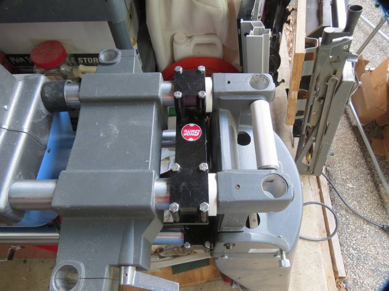

Since that is the really tedious part of the re-instillation I've been thinking of some ways of making it better. Some years back I had played with several methods of improving the headstock/carriage location so it was more repeatable(never got it to the point I was happy with it). One of thing I tried was PVC pipe for spacers. While they didn't work well there they looked like they might for this use.
So lets look at what I did.

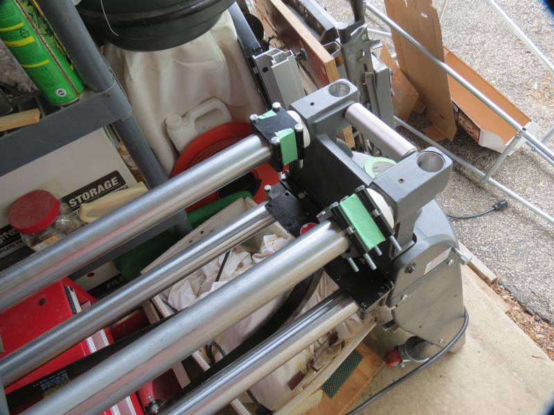

Measured and cut some pipe (7/16" ish wide) then verified a nice snug fit.
[ATTACH]21979[/ATTACH]
Pulled the cylinder end off and when back to horizontal.
[ATTACH]21980[/ATTACH]

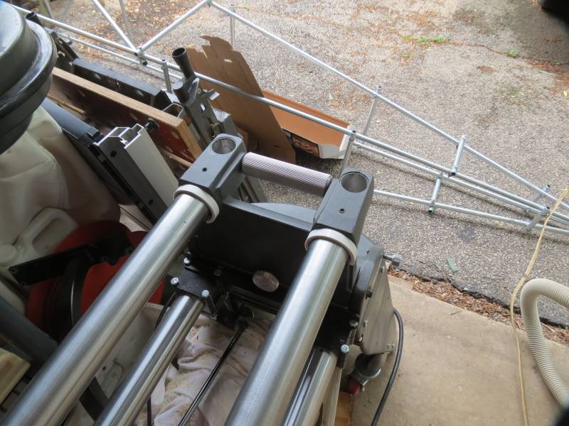

The top bracket was then removed. The lower bracket remains in place.
[ATTACH]21981[/ATTACH]

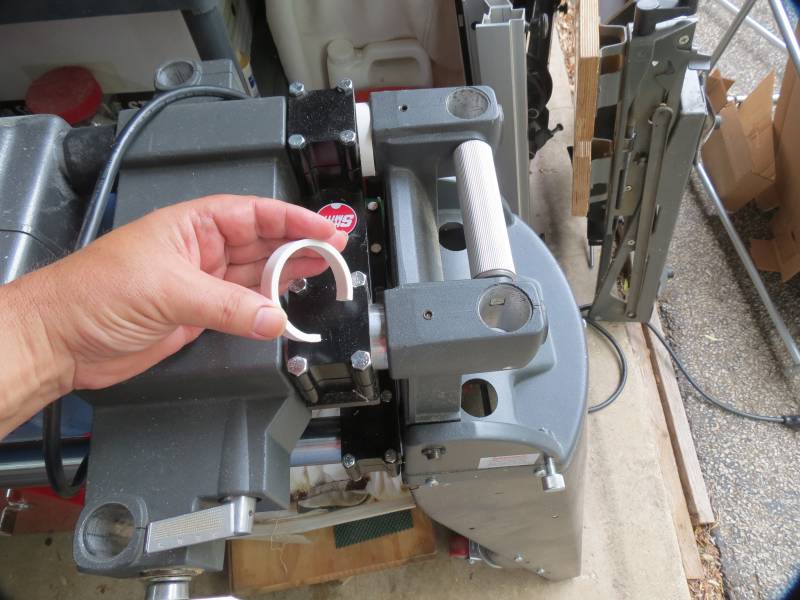

Going from scratch I put the pipe spacers on.
[ATTACH]21982[/ATTACH]
Next I put the upper and lower blocks on with the screws in place, the green tape helps things stay in place as the upper arm is attached.
[ATTACH]21983[/ATTACH]

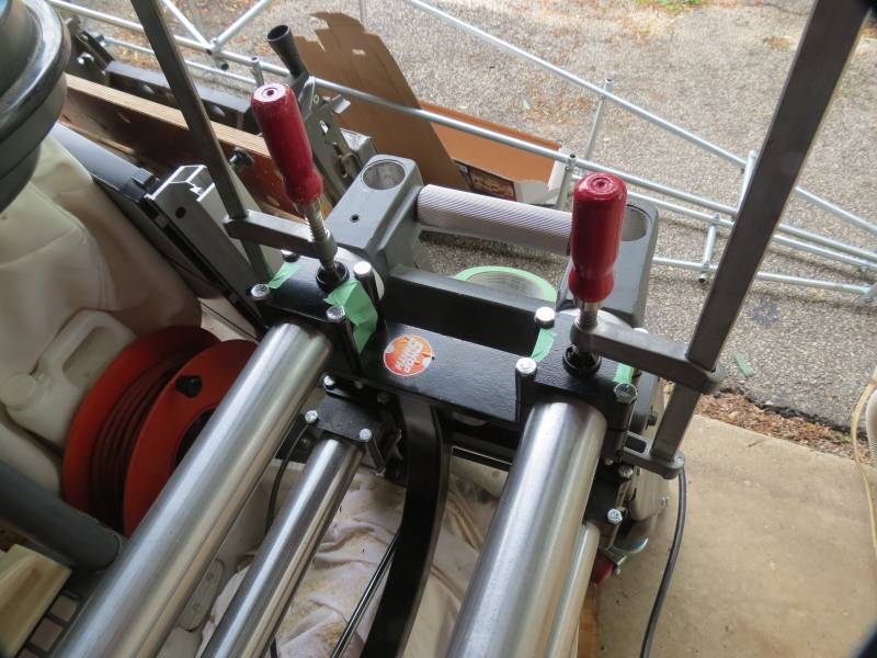

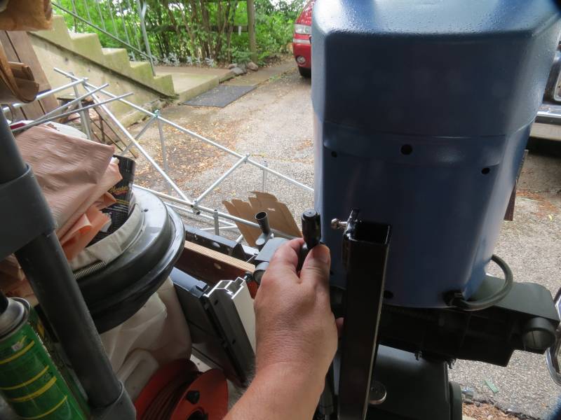

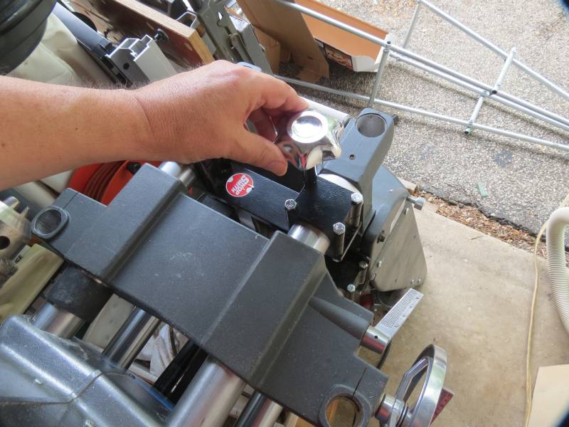

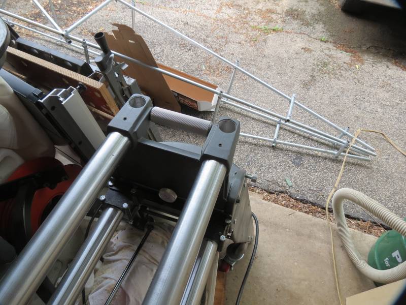

I've found that a couple of clamps help hold the upper arm in place and it is easier to get things to fit this way.
[ATTACH]21984[/ATTACH]

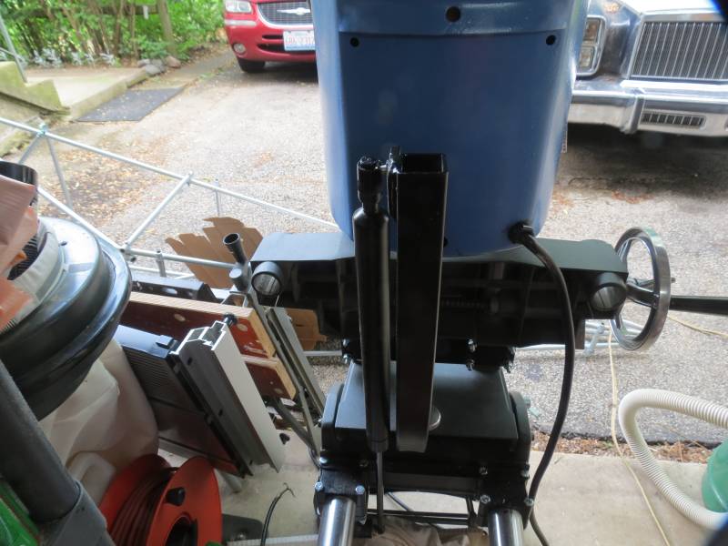

With everything re-tightened and checked it is time to go vertical again.
[ATTACH]21985[/ATTACH]

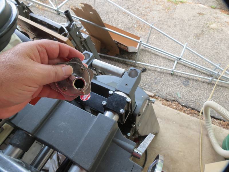

Will the ball fit the socket or will I have to mess around to get things to fit again? Happy to say the fit was perhaps even better then before (wishful thinking on my part?).
[ATTACH]21986[/ATTACH]
I grabbed a hand socket to make the process go a little faster. Years ago I could have tightened it all the way but now I go back with a wrench just to check.
[ATTACH]21987[/ATTACH]
[ATTACH]21988[/ATTACH]
Now I would not want to do this for some little thing that I could do a work around on but for projects that need it I'll just go for the removal and re-installation. It goes pretty fast now and no readjusting time or effort so I'm about as happy as I'm going to get with the lift assist.

Looks doable.
One question: I notice the screws all same length. Did your L-A come so equipped? Part of install for me that is such a PITA is that I got 4 different size screws, odd quantities each (looks like somebody was packing from a "Miscellaneous" bin) and I have to hand pick each one to get 'em all to fit. That's "GRRrrr" times 16.
[if I reinstall- and I may, using your method- I'll go buy all new screws and some kinda keeper to hold screws to top blocks]
All the hardware is oem (shopsmith).keakap wrote:Looks doable.
There are two screw sizes listed, (4) 1/4"-20 x 2-3/4" and (12) 1/4"-20 x 3-1/4". The (4) shorter screws are used on the lower assembly opposite the lower mount.
Mine is only a couple of months old so it could be older units were different?? I believe I have seen pictures of units that have a tie bar on the top (which mine doesn't), so that could be another issue??
