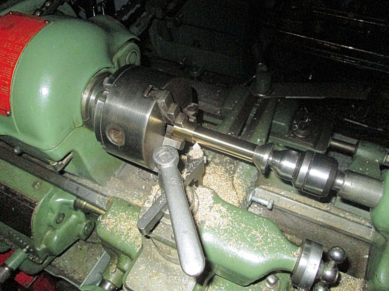

Recently finished an interesting project for a friend who is restoring a 1973 BMW. He wanted the shifter knob made from oak and he will be gluing a 1973 10 cent piece in a recess in the top and varnishing the wood.

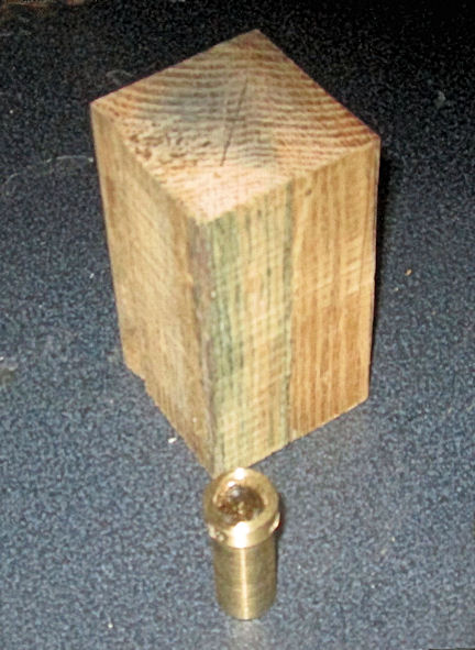

I turned a core from brass on my 10K South Bend metal lathe and epoxy glued it into the oak block. I installed three 1/4" set screws in the bottom of the core for mounting in the car and I used them to mount the block on a steel mandrel so I could hold it in a 3 jaw chuck on my Mark 5.
[ATTACH]21991[/ATTACH]
[ATTACH]21992[/ATTACH]

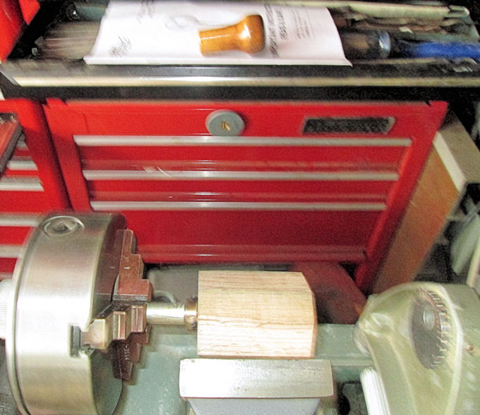

Here it is ready to turn with a sample knob in the background:
[ATTACH]21993[/ATTACH]

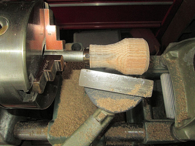

Turning continues:
[ATTACH]21994[/ATTACH]

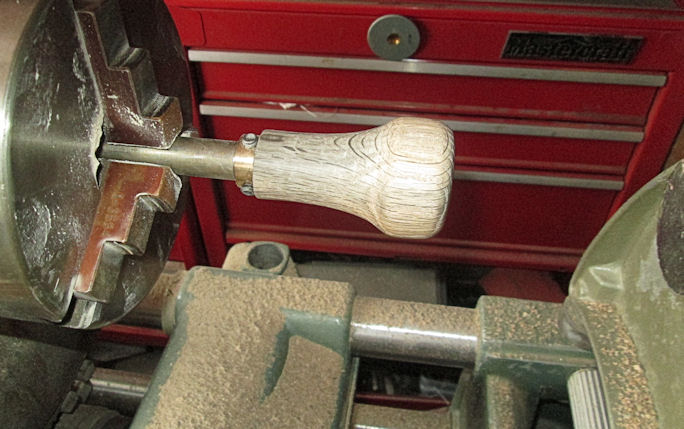

Close to shape:
[ATTACH]21995[/ATTACH]
Note that the Mark 5 is the one that I put the variable speed sewing machine motor on to replace the non working original.......worked great.:D More in next post.

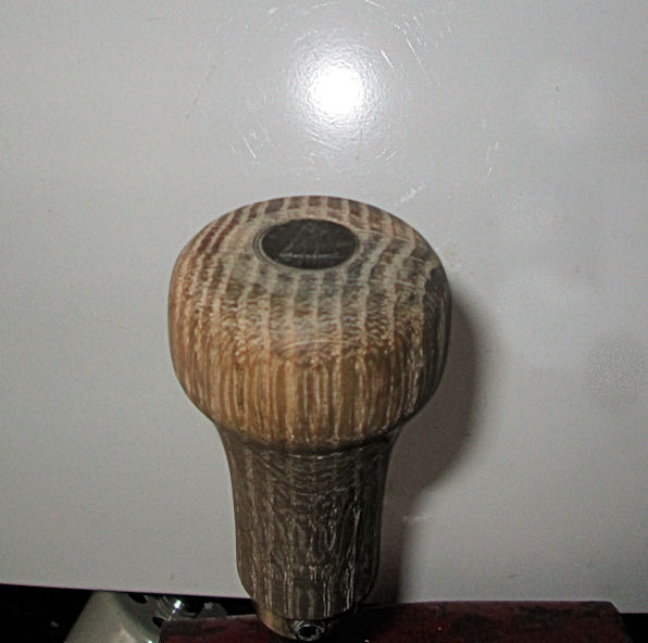

I turned a recess for the coin using the South Bend because I could control the size better with the dials than by my shaky hand.:) Here it is with a dime to check for size.
[ATTACH]21998[/ATTACH]

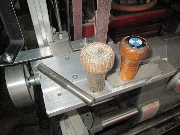

Here you see it with the example knob and the steel mandrel used to mount the new knob on the lathe. The new knob is made a little bigger than the example:
[ATTACH]21999[/ATTACH]
