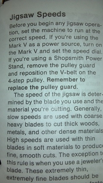

What is the rpm range the magna jig saw is designed to run?
700 to 2200

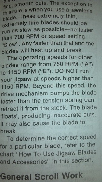

Per the manual....
[ATTACH]22153[/ATTACH]
[ATTACH]22154[/ATTACH]
So "A" 700rpm to "E" 1150rpm max.
We don't want speeding tickets do we?

pieceseeker wrote:Per the manual....

Apparently Magna was making their living selling blades, till owners wised up and went slower. Then Magna went out of business!
