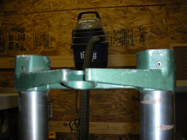

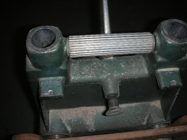

I tried to stack washers to see if it would "cant". It would not. One washer on the left raises the right exactly one washer and via versa. It seems that the tie bar is very firm. In the pictures below, you can see that the tie bar is locked onto the way tubes with set screws.
[ATTACH]898[/ATTACH]
[ATTACH]899[/ATTACH]
I'm wondering if I loosen the set screws if I'll get enough "play" to twist the assembly. Then I could add a set screw to the bottom platform, make the adjustments and then tighten the upper set screws.
What do you think?

Try it. Sounds worth it. I've an old '54 Magna I'll try it on...
Still waiting for it to warm up to align my 520 tables. Like Dusty, I had given up and had a right and left designated. If they now will align on either side of my 520, then I will hope one or both will interchange on the '54.
Let us know what happens.....

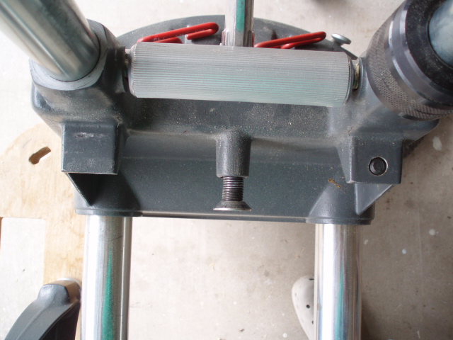

Are you certain that you need to have an adjustment?
After viewing this on the Sawdust Session, I went to adjust my own because I have felt that I had something wrong. My alignments are sometimes found to be incorrect; I believe this to be after some Shopsmith relocations.
What I found was that the headrest does not even contact the setscrew. Adjusting it would have no effect. To make the setscrew contact the headrest, I had to screw the setscrew almost all the way in. I did that but if it does anything it is to provide a more stable reating place for the headrest.
Providing the adjustment capability to machines that don't have the screw, however, seems a simple task. 1) Drill a hole, 2) tape the thrteads and 3) insert setscrew.
