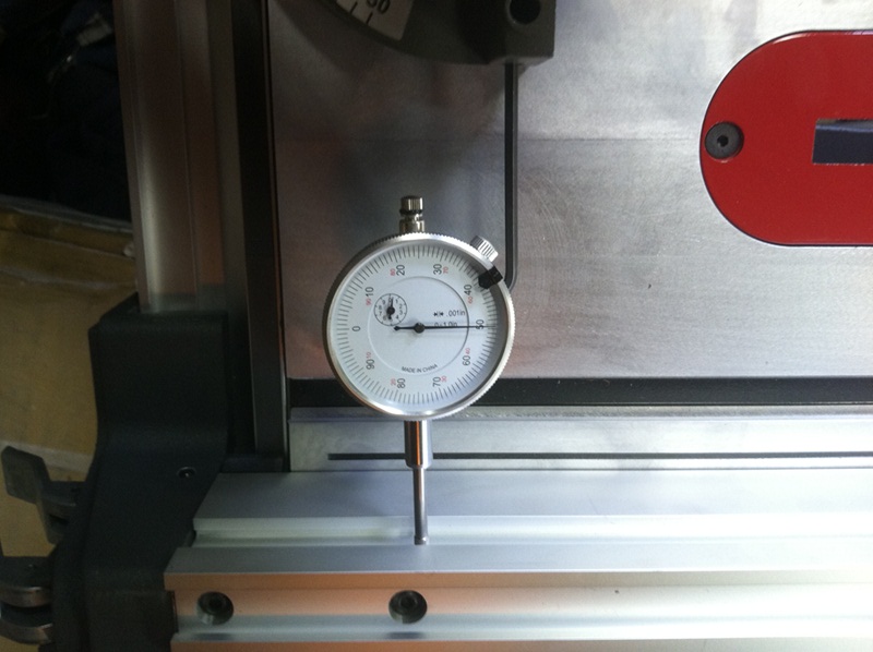

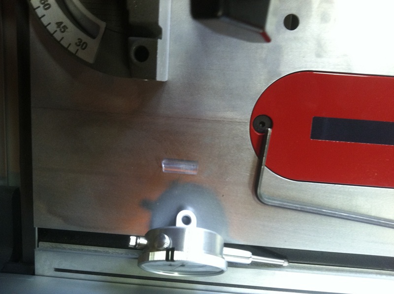

Anyway, I had watched the setup of the table on the old videos where they used the L shaped hex wrench and thought that it was okay accurate :rolleyes: , but not great so I bought a cheap dial indicator with the idea that I would make a runner to fit in the miter slots then attach the gauge and check out the table to the blade and fence.
Then I though I might be able to adapt the old style hex wrench to the dial gauge as shown in the video.
What I found is that a small piece of 1/4" flexible tubing "snugly" fits in the hole in the back of the dial gauge and the wrench can be pushed into the opening in the tubing, making a reliable adapter.
I presume many others have found this same solution, but after a brief search I didn't find any other posts.

Ed is completely correct.
Yes, I do use the set screw in the miter gauge to hold the wrench (as in the old video) and since the wrench is hexagonal, the flat side is held firmly by that screw.
The tubing is a very snug fit both going in to the bracket on the back of the dial indicator gauge and then pressing the short end of the wrench into the tubing. The gauge doesn't slip at all.
To check for slop in the bar and somewhat compensate for it, I did tighten the middle set screw that widens the miter gauge bar enough to remove slack and then further tightened it at each far end so the miter would not move when checking readings just in case. That has nothing to do with the attaching, but wanted to assure that I was trying to keep things accurate.
