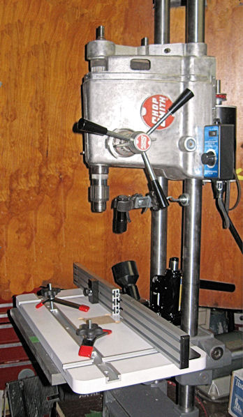

I tried this table (similar ones available from Rockler) for awhile but for my use, mostly drilling metal, I did not like it. It clamped on from underneath:
[ATTACH]22390[/ATTACH]
[ATTACH]22391[/ATTACH]
- IMG_1328.JPG (65.92 KiB) Viewed 4395 times
- IMG_1327.JPG (99.54 KiB) Viewed 4397 times
Peter

Thanks for the pictures. That table looks like exactly what I need. Why don't you care for it? I'm off to search Rockler's site.

That table looks to be very functional. The problem that I would have with it on a drill press would be "what happens to it when I fail to use a backer board". It may be that Rockler has already taken care of that. I see what might be a sacrificial insert in the center of the table.
However, looking at this table of Peters, I realize a problem that I would have. The auxiliary table raises the work surface and on my Shorty I have already reduced the height of stock that I can drill. I can not afford to reduce it further.
This is the only issue I have seen/experienced with my Shorty so far.

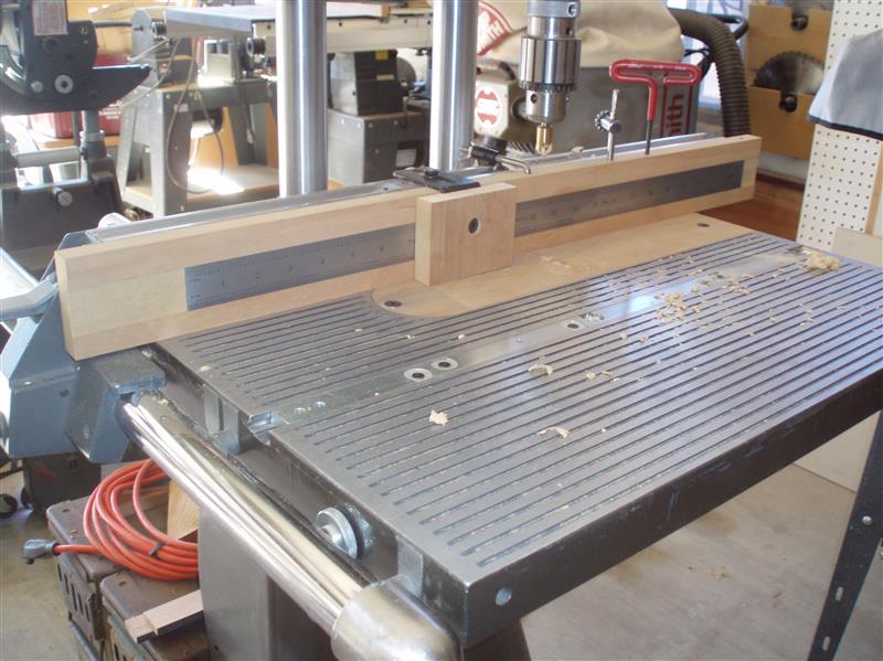

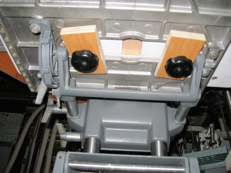

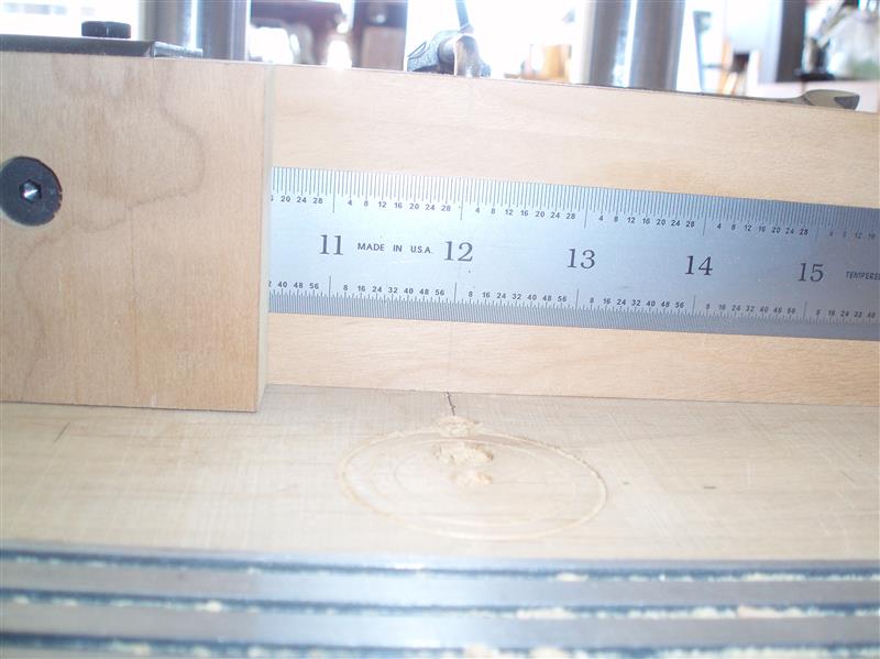

[ATTACH]22393[/ATTACH]
[ATTACH]22394[/ATTACH]
These are changes that I had to make to my drill press to make it efficient.
- Drill Press, Table Accessories 003 (Custom).JPG (87.99 KiB) Viewed 4381 times
- Drill Press, Table Accessories 005 (Custom).JPG (54.76 KiB) Viewed 4386 times
