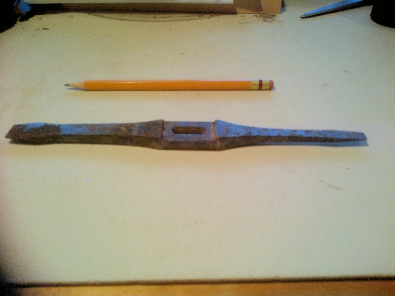

I found this double ended screwdriver sans handle at the local ReStore, only $1.00.
[ATTACH]22514[/ATTACH]
I am thinking it will work well for adjusting hand planes, the wide end is the right size for for the cap iron screw and the narrow end for the smaller screws.
Has anyone seen a screwdriver like this? If so what did the handle look like?
My thoughts are either a small grip in the centre or a long handle that would pivot to expose one blade and enclose the other.

Well, I checked Stanley, Sargent, and Millers Falls catalogs in my tool library and came up blank. I will look some more as I have some smaller manufacturers and other source material. My intuition (guided by experience) tells me this is a screwdriver that came with a set of automotive or tractor tools; perhaps a model 'T', or other vehicle that required a center slot to turn a square head screw adjustment. It might even be steam tractor vintage or a railroad engine tool. Just guesses mind you, but I don't believe this falls in the woodworker's tool box - not that it can't be used to adjust planes.

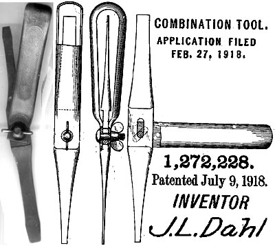

WmZiggy, thank you for your research.
Gary, thank you also, you nailed it.
Earlier I was out in the shop and cleaned off most of the rust and dirt and out popped the stamping.
PAT. JULY 9, 1918
J L DAHL
HACKENSACK
[ATTACH]22526[/ATTACH]
I found the patent drawing on this site
Directory of American Tool And Machinery Patents
It shouldn’t be to hard to make a replacement handle.

Good to learn this one, and it's rare. I looked in 12 tool catalogs from the turn of the century, and one that included everything Stanley and Sargent ever made which included lots of patients they bought-up, and nothing on this hummer. Fun researching though. Thanks for the tool stumper.

I do not think I would want to bear down on the 'dormant' end to keep the blade in the screw slot.frank81 wrote:I like the description in the patent that says you can fold the handle out at 90 degrees for extra leverage. That would make it a 3-in-1 combination tool? Tighten screws, loosen screws, and STRIP screws!
Using the handle for leverage may be why this one is missing it's handle and may be a reason it didn't last in the market place.
