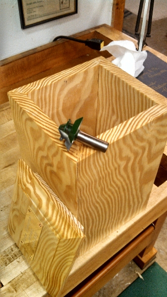

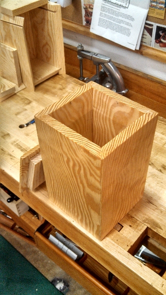

This is not your usual woodworking request. My brother-in-law passed away on August 2nd and the family on my wife's side asked if I would make a box for his ashes. Blake died young at 68, taken two weeks after being diagnosed with cancer. A Vietnam Vet (Army medic) I can only wonder if exposure to Agent Orange was the source of his cancer. He wouldn't go to doctors or visit the VA, and had a mistrust of institutions in general, all legacies of Nam, but he served his country honorably at a difficult time. I hope I served him as well in a final resting place.
I chose Spruce that I had laying around in the shop and settled on 6.5 x 6.5 x 10 inches which created over 300 cubic inches, a size recommended by an undertaker friend. I used a 1/2" shank 45 deg lock miter bit on the sides and a floating panel in the base. In the second pic off to the left, you can see my prototype with the floating bottom. I was going to use a sliding lid and the sides were plain miters without the interlocking ledge. I didn't like it, made adjustments, and started over. The top is routed with an ogee edge and fitted with a base that is friction fit to the inside of the container. My wife wood-burned a chess figure and cross on the face to create a front to the box (chess was his favorite game) and we fitted a brass plaque on the lid. I finsihed the box or urn with several coats of poly. Here are a few shots:
[ATTACH]22552[/ATTACH]
[ATTACH]22551[/ATTACH]
[ATTACH]22550[/ATTACH]

- Urn corner view.jpg (231.61 KiB) Viewed 6423 times
- Urn with router bit.jpg (220.71 KiB) Viewed 6430 times

I was most pleased with the way the 45 degree lock miter bit worked. I bought it several years ago and had never used it. I set my Grizzly woodshaper up to handle router bits and I was pleased with the outcome.

That 45 degree lock miter was easy to use and set-up with a couple of set-up passes. I would not want to use it on anything but a table mounted router, or in my case my shaper fitted for router bits, that has a fence and anti-kickback boards. I suppose it could be used in an upright hand-held router with fence, but that just didn't feel right to me and you know what they say...

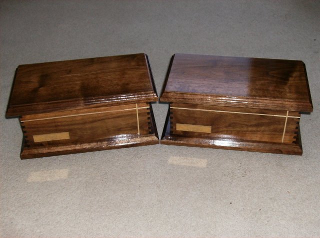

My father-in-law passed away last month and after his funeral was over I was asked to make two boxes (the other will be for my MIL) to serve as urns. The cremation society, upon my request, gave me (free) one of the cardboard boxes they use. I'd be surprised if anyone charges $250 for the cardboard box. The box was 9.75'' X 6.5" X 4" (all OD) for a total of 253.5 cu. in. His ashes fit easily in this box size. FWIW, one internet search I found gave a rule of thumb of 1 cu. in. per pound of body weight.
