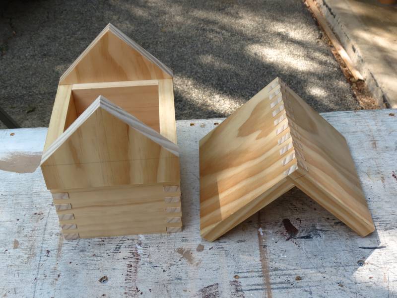

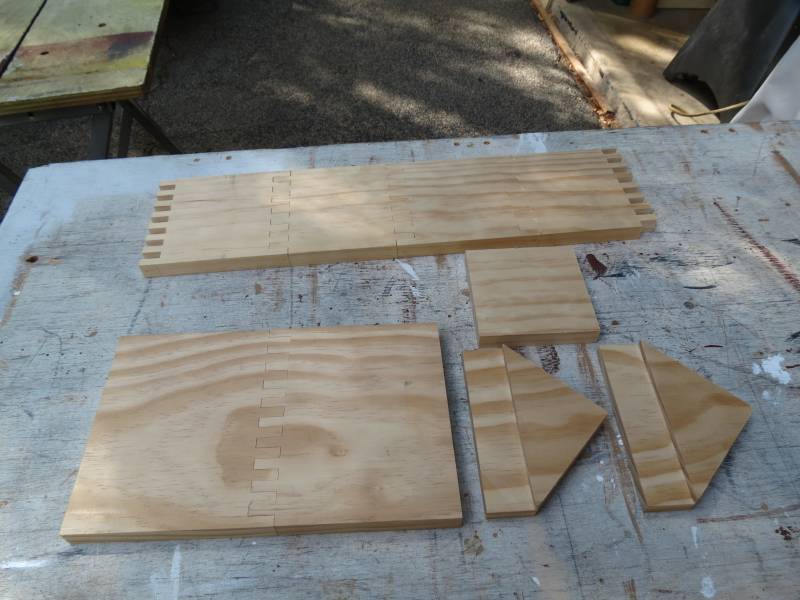

This will not be a how-to, just a few pictures.
[ATTACH]22686[/ATTACH]
[ATTACH]22687[/ATTACH]
[ATTACH]22688[/ATTACH]
I'm doing this for my grandson who is interested in birdhouses. He will be 8 in a short while and I think this will be a good gift.
The problem I'm having is I have no idea what an 8 year old is capable of doing especially since he lives in DE and we don't get to see each other very often. My last 8 year old is 30 something now....
I think gluing the box joints is too much so I will do that. Perhaps I can pre -drill the holes for the bottom and he can mount that. Maybe have the roof and gable ends as a sub-assembly that can fitted the main house, (also pre-drilled). Pre-drill for a perch?
Send some cash for a brush and spar varnish?
Anyone with a fresh 8 year old care to comment?

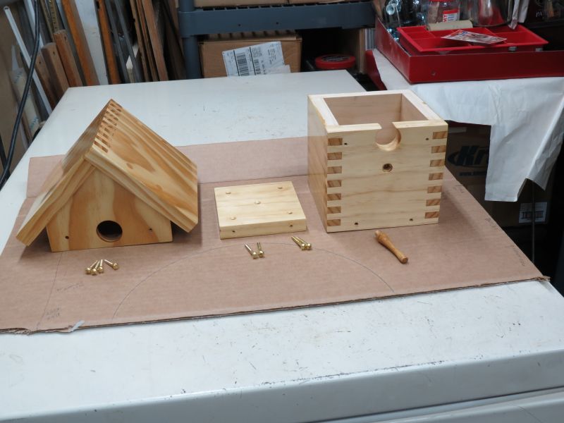

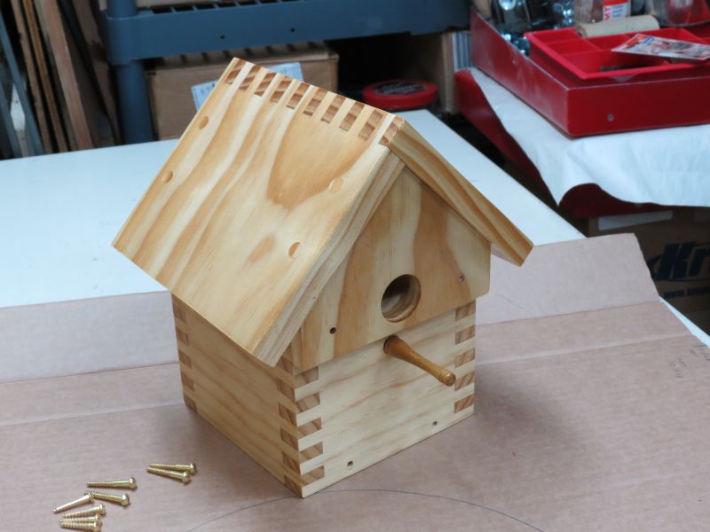

I'm finally ready to send this birdhouse off! Yea it never got finished last fall and even sat over winter, now it's May and a little late for the DE spring but still early enough for some action.
I was going to have more things for the grandson to do but with busy parents of three I decided to give them a break and do the sanding and finishing and limit the assemble to the bottom (4 screws), top (4 screws) and the perch (glue).
Spar varnish will need touch up/redo so the sanding and brushing will be have to be done at other times, for years to come if they decide to keep it that long.
The roof is attached with brass screws covered by wood plugs. The top then is attached to the body with 4 round head brass screws. The bottom will serve as access for clean out is attached with 4 round head screws.
The perch is turned and glued in place as a final step before hanging it up. I've added some vent holes at a slight angle to the back along with a small amount of venting under the eaves. The bottom has drainage hole as well as a small amount of vent space on two ends.
I'm also sending a set of screwdrivers (HF) and some insturctions for what is left to do on the project.
The next one I send will be more of a kit for him, perhaps out of cedar so he can do more of it himself. Got a plan already....

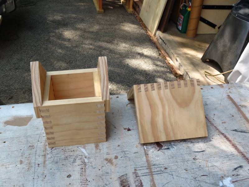

To be honest I've never seen a birdhouse with box joints but it was a fun project and I'm glad I did it.
This project was two fold, one to try out the box jig, and two some thing for the grandson, it did both.
I had made the joints a bit looser then I would normally so it would be easier to put together, as it turned out I did the assembly so the next test will be to make joints that are snug to see how that works.
