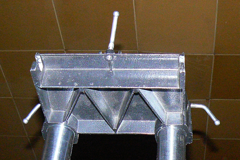

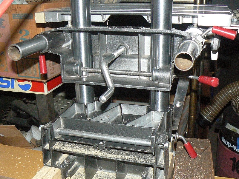

Here is my cobbled together 'portable' shopsmith made from some Mark 2 parts and some other stuff.
Some talk has concerned the 'bench' tubes/2x4 base. My parts were likely of the 2x4 variety. This made it easy to mount it to my home brew base.
Notice the square shape of the bench socket and the lag screw hole.

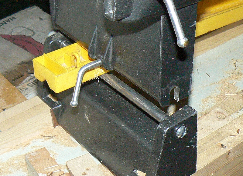

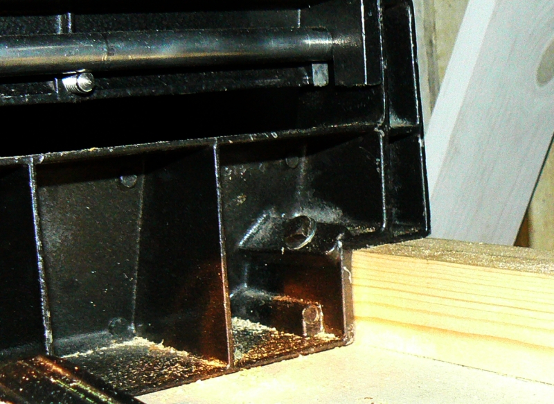

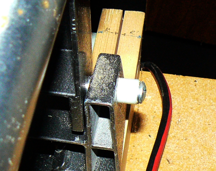

The left base mounts SPTs, but secures them with offset screw shaft 'knobs' like a model 10, but much smaller. The bandsaw offset is redundant for the Mark 2 since like the Mark 7, the SPT base is part of the tie rod and goes up when raised to drill press position.
[ATTACH]22710[/ATTACH]

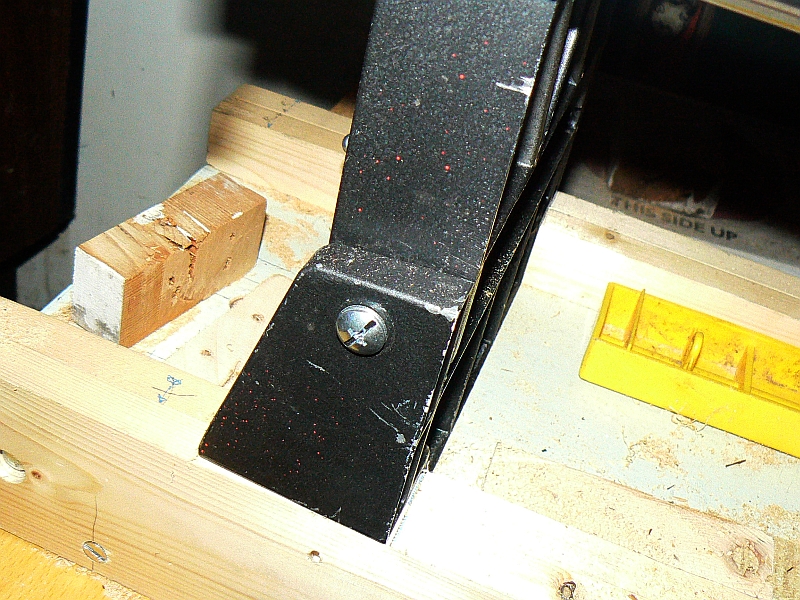

The right base also mounts SPTs, but the front 'knob' is different. As will be shown later, it does double duty as a vertical lock in drill press mode. There is a second 'knob' on the back side.
[ATTACH]22711[/ATTACH]

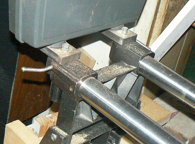

The hinge pins were originally 'secured' by push on washers with 'fingers'. I replaced them by tapping a hole in the pin and using a washer and screw to secure it.
[ATTACH]22712[/ATTACH]
The pins are longer than the casting, so a sleeve was slipped over the excess on the back end.
[ATTACH]22713[/ATTACH]

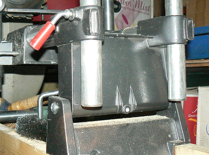

While we are on the subject of 'tilting', does the following remind you of a newer version?:D
[ATTACH]22714[/ATTACH]
And the lock down method?
[ATTACH]22715[/ATTACH]

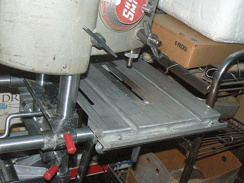

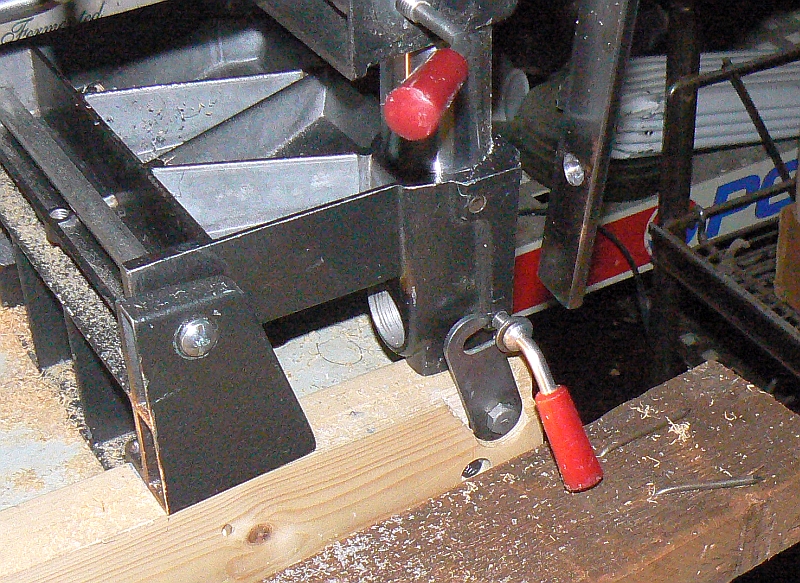

As promised, the vertical lock uses the front SPT 'knob'. The slotted clamp goes over the screw and prevents it falling by having a slope on the slot that prevents accidental 'lowering'. The clamp must be rotated off the screw to lower.
[ATTACH]22716[/ATTACH]

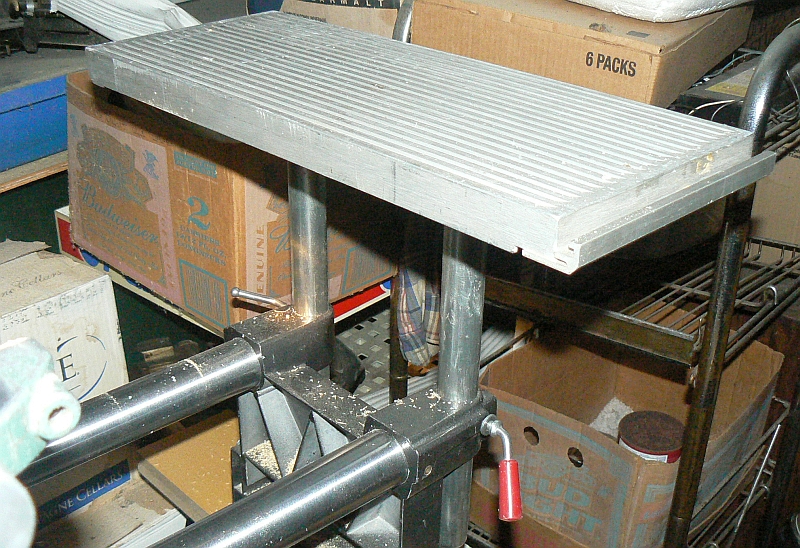

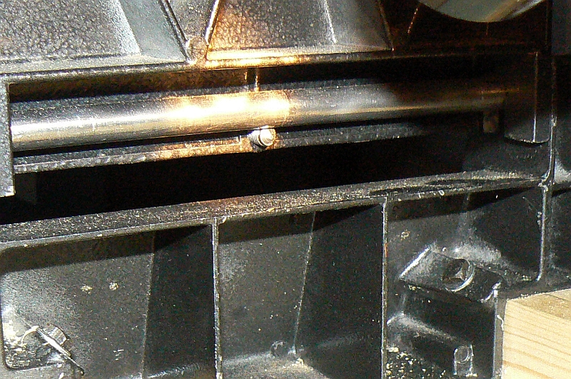

While 'raised', a look at the underside of the carriage. Notice the model 10 type table raising crank and the thiness of the casting(s). The carriage lock is essentially the same as the other 'Mark' models, but the offset knob is used. Same wedges and left/right handed threads.
[ATTACH]22718[/ATTACH]
Notice also the table support tubes. No rack teeth, and the two 'knobs' that lock down the table just like a Model 10, except the tube size is 1 1/4 od.

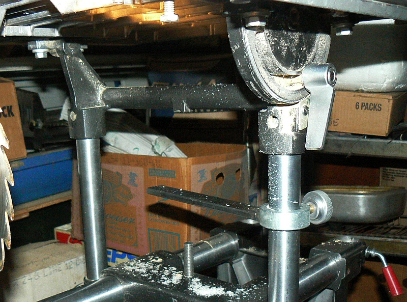

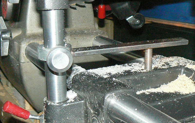

Moving on to the work table, the trunion is Mark 5 vintage.
[ATTACH]22719[/ATTACH]

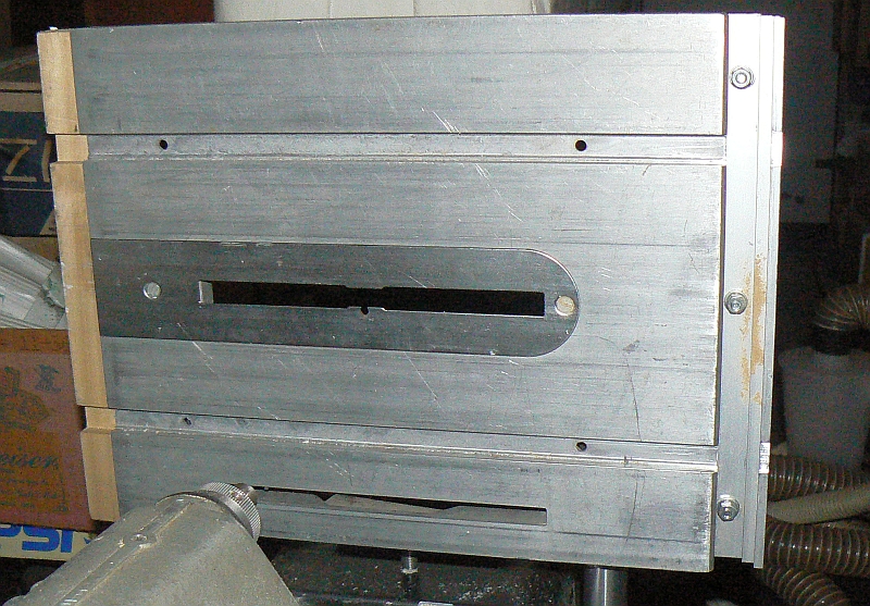

The table lift arm did not arrive with the mM2 stuff, so I needed to make one. A 1 1/4" collar is welded to a bar with a dimple on the underside for the height crank to register in. The knob is a model 10 table clamp(brass threads).
[ATTACH]22720[/ATTACH]

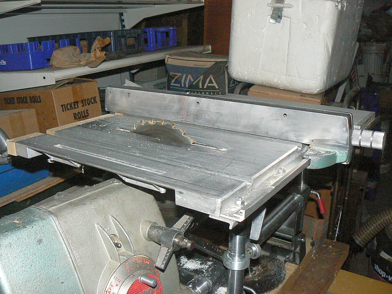

A M2 fence did not arrive either, so the table was modified to use a Mark 5 fence. The table is 'shallower' so the back side was 'extended' with a wooden extension. The front rail is different, but by mounting a Mark 5 rail to the Mark 2 rail mounted upside down, the Mark 5 fence will clamp properly.
[ATTACH]22721[/ATTACH]
The rear extension is secured by a screw using an existing threaded hole in the table.
[ATTACH]22722[/ATTACH]
And yes an SPT mount on the right end. FWIW the end castings are identical.

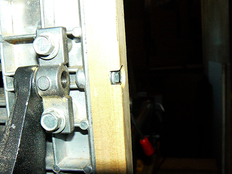

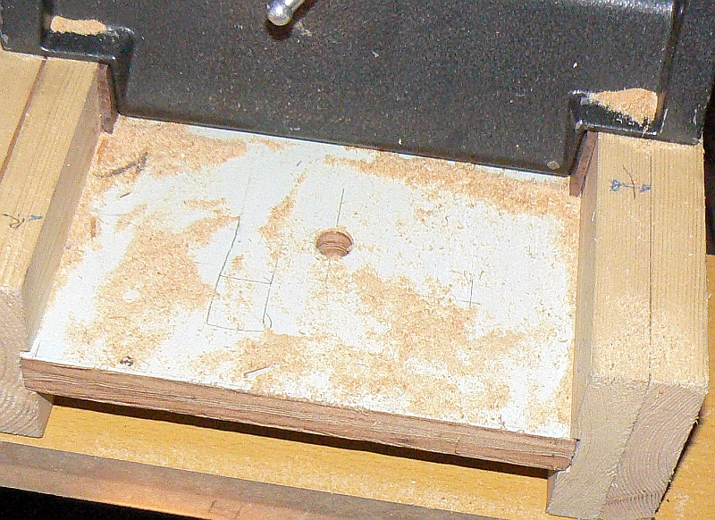

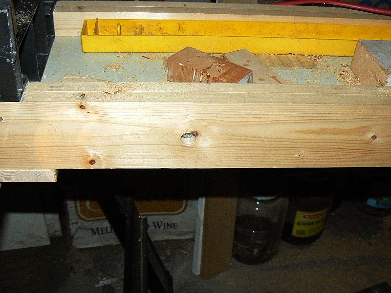

Now for the bench stuff. A 3/4" plywood base holds doubled 1x3(?) rails on both the 'front' and the back. The inside rail is grooved for the plywood. The rails are lag screwed onto the plywood. The end castings are lag screwed to the rails. The plywood is secured to a saw horse at each end using Model 10 knobs that screw into t nuts from the bottom of the horse. A cross board on the bottom of the plywood prevents the horses from rotating.
There is a captive t-nut in that hole.
[ATTACH]22726[/ATTACH]

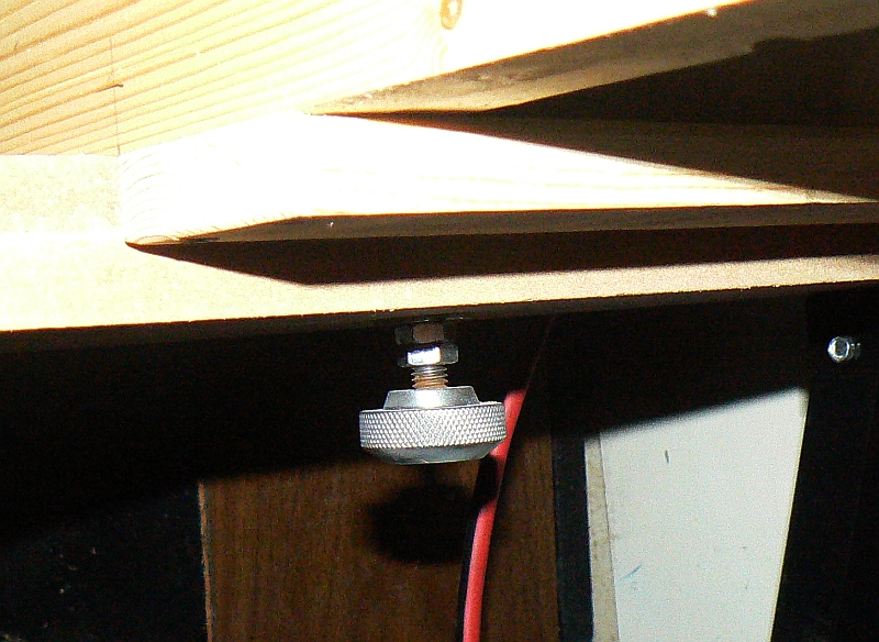

Plywood base/saw horse clamping knob and anti-rotation cleat. The jam nuts limit the amount of screwing needed to tighten the base to the saw horses which BTW are from Harbor Freight(nice wide flat top).
[ATTACH]22727[/ATTACH]
The counter-bored lag screws holes do not extend through the outer rail.
[ATTACH]22728[/ATTACH]
If you have not already noticed, there is a Mark 5 headstock in this hybrid. It is a Greenie/Gilmer/3/4 hp.
[ATTACH]22729[/ATTACH]

I have minimal use with this beast, but I like it in spite of a couple of things. The horses place the saw table(and every thing else) higher than a Mark 5. Not a problem for me, but shorter folks would struggle with it. The saw blade is a mark 5 9" combination blade(my Goldie original), but I have since been spoiled by newer carbide tipped blades.
For transporting, the headstock is removed to decrease weight. The horses fold up.
FWIW, the way tubes were obtained on e-bay a couple of years back. I am 'looking' for a Mark 2 fence so I could then remove the work table
alterations.
A Mark 5 miter gauge is also used with this menagerie.
