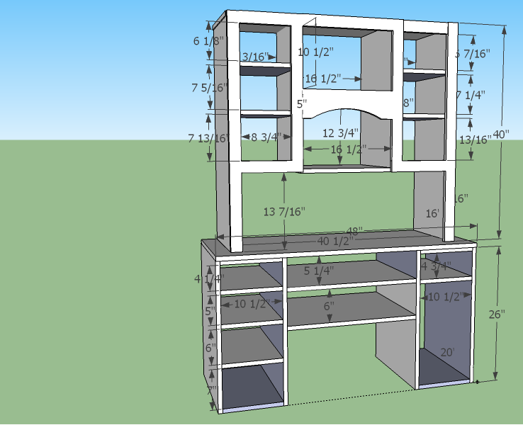

Drew up my version of the thing and got approval. I'm not much of a sketchup artist, but only wanted to give her an idea of what it would resemble.

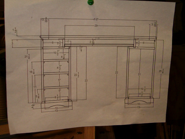

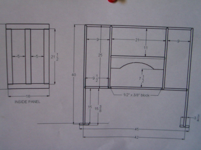

In order to start sawing first had to draw up a more detailed plan. Didn't care for the wide face frames as they made the unit look a bit clunky IMO. Here's photos of the printed plans.
First the bottom parts -
[ATTACH]22774[/ATTACH]
and the upper parts -
[ATTACH]22773[/ATTACH]

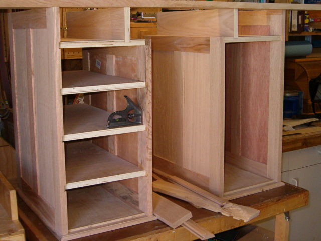

It was plain to figure the thing had to be built in pieces that could be dis-assembled to carried into and through the house. I could glue and screw up the parts, but each part must be carry-able by one person. So - the building began.
First the two loser bases.
[ATTACH]22775[/ATTACH]
These two pieces are light enough and small enough to be handles separately. Although I tried to make the drawer holes perfectly square, that didn't happen. Oh well I can make un-square drawers. If the drawers are made well enough there is no need for sliders.

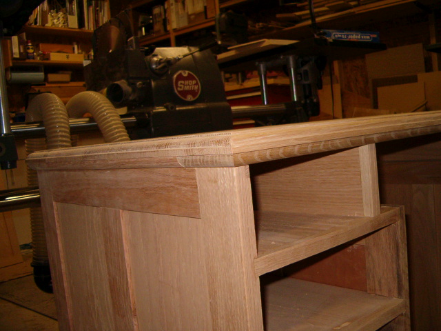

So the sub-desktop had to have grooves and dados that would fit into the upright stubs of the two bases. The sub-desktop is nothing more than a frame of about 3" wide pieces, with butt joints glued together with biscuits. The grooves and dados were hand cut with a couple of chisels.
[ATTACH]22776[/ATTACH]

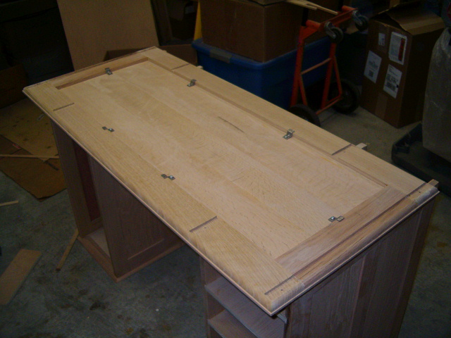

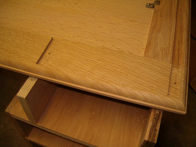

This sub-top will be carried separately and fastened to the desktop with Z fasteners. That way the bases can be moved into position on the rug in the sewing room and positioned correctly in the dados and groves of the the sub-top. The sub-top will be screwed to the two bases.
The desk top will then be placed on the sub-top and fastened with the Z fasteners. Hese's the bottom view of what that will look like.
[ATTACH]22777[/ATTACH]

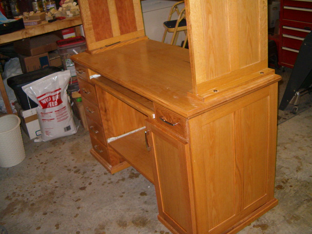

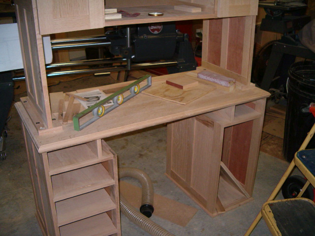

When the desk top is fastened onto the sub-top and set on the two bases this is what it looks like.
[ATTACH]22782[/ATTACH]

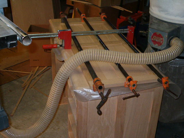

Sorry- it has become obvious I didn't snap enough photos, but here is a pic of gluing up one of the outside paneled stiles of the upper cabinets. I used the two bases as a table. (all stiles of the boxes are paneled with 1/4" oak plywood to cut down n weight)
[ATTACH]22783[/ATTACH]

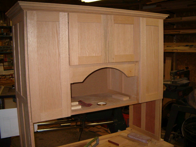

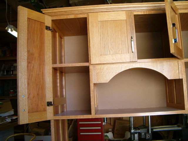

Here is what it looked like (2 pics) when the two upper cabinets were fastened to the desk top and the stabilizing shelves were placed between them. Also doors are mounted in this pic.
[ATTACH]22784[/ATTACH]
[ATTACH]22785[/ATTACH]
Now that the total cabinet is finally finished, I'll get some more photos to show the finished product.

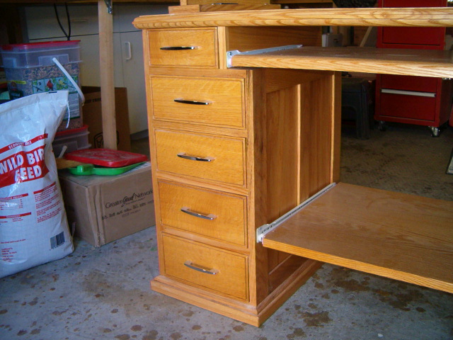

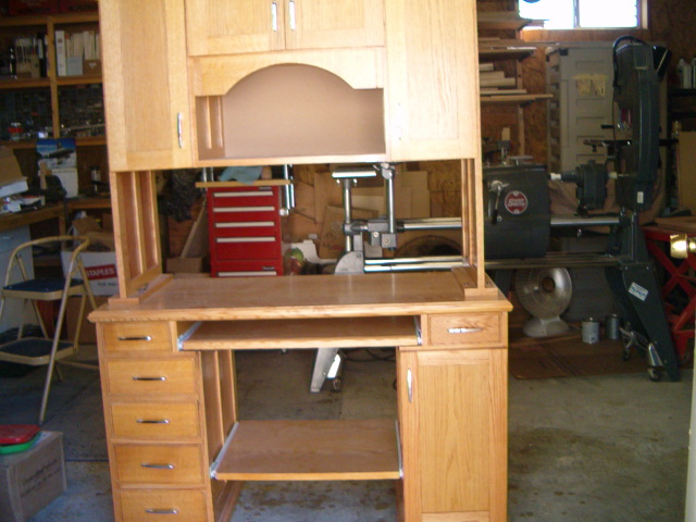

O.K. this is getting long - never fear it will end in these last two posts. Had to try to take pics of the finished computer Center.
Sorry about the glare. Couldn't help it. The only place I could back up far enough to get the whole thing (almost) in was by the open shop door. All the light is coming from the shady side of the shop.
[ATTACH]22791[/ATTACH]
So here are some other shots:
[ATTACH]22792[/ATTACH]
Since the drawer openings weren't perfectly square, I cut beads around the drawer fronts in order to hide the crooked fitting.
[ATTACH]22793[/ATTACH]
[ATTACH]22794[/ATTACH]

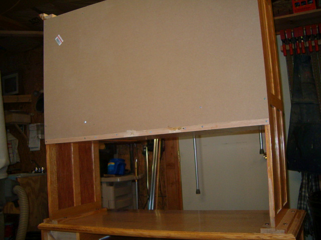

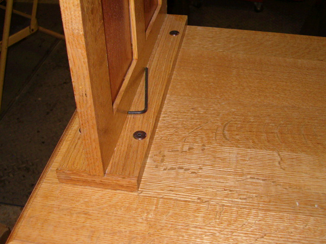

this is how the upper parts are fastened to the table.
[ATTACH]22795[/ATTACH]

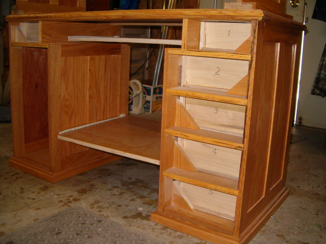

Here's the back - only the upper part has a backing. The right side back is left open for ventilation in case a tower is put in there. Her computer right now is a desk top and there should be plenty of room for it.
The drawers have been numbered to avoid trying to put them into the wrong hole. The triangle pieces were not necessary for stabilization, but were used for drawer stops.
[ATTACH]22796[/ATTACH]
[ATTACH]22797[/ATTACH]
