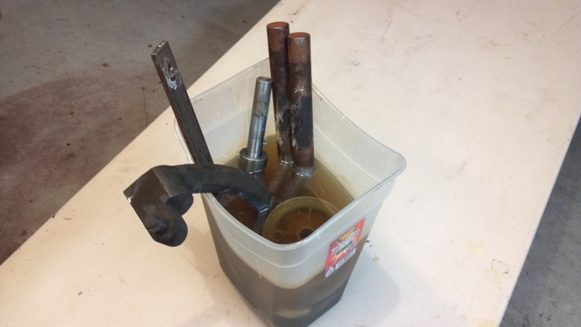

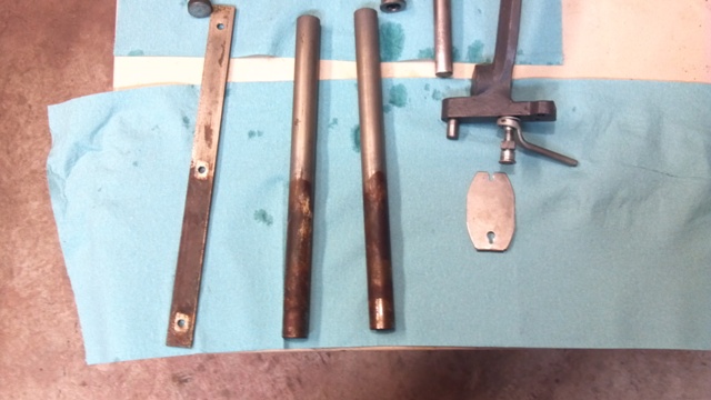

Buy a gallon. Place the part in a pan and rotate it as required to cover all sides over a few days. I leave it in the solution for 24 hours before rotating the part if the gallon won't completely cover it until it's all done. You can reuse the solution over again as long as you keep it covered in the pan with foil so it won't evaporate.
[ATTACH]22804[/ATTACH]
only half of some parts fit in solution at a time.
[ATTACH]22805[/ATTACH]
half done after 24 hours.

Thanks for the advice. I especially appreciate the pictures (worth a thousand words). I will get a gallon and use a bucket that fits the pump closely. I have some old drill bits and a #5 Stanley plane base that I will clean after the pump. This looks much easier than my previous method - WD40 and a 8 inch wire wheel on the lathe. Thanks again! Now I have another question related to contact cement. I will post a new thread.
