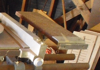

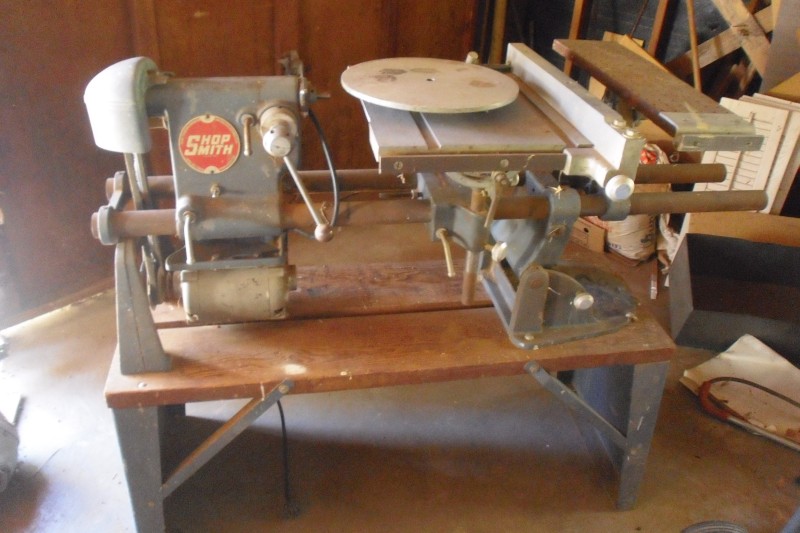

From Yahoo. 10ER like rail added to 10E wooden extension table.
http://groups.yahoo.com/neo/groups/Shopsmith10ERusers/photos/albums/1173653092/lightbox/2018868144
In case the link doesn't work for thee.
[ATTACH]22832[/ATTACH]
- 10E ext table mod.jpg (76.43 KiB) Viewed 3342 times
The extension table mod is nicely done. It is also interesting how they shortened the bench (but not the tubes), although I don't think it would work in drill press mode.

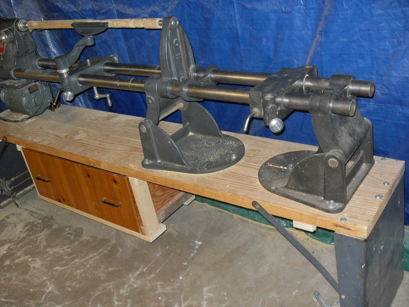

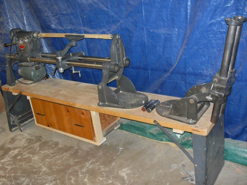

Did you notice the 10ER with longer bench and lathe extension?
http://groups.yahoo.com/neo/groups/Shopsmith10ERusers/files/Accessories-Modifications/10ER%20Lathe%20Extension%20Tilt
for some reason it was posted in the files section not in photos. Here are the photos for those who are not members there.
[ATTACH]22836[/ATTACH]
[ATTACH]22837[/ATTACH]
[ATTACH]22838[/ATTACH]
[ATTACH]22835[/ATTACH]
- 10E+4388-#1.JPG (94.36 KiB) Viewed 3322 times
- Shop Smith with Extension No 1.JPG (104.65 KiB) Viewed 3327 times
- Shop Smith with Extension No 2.JPG (120.83 KiB) Viewed 3325 times
- Shop Smith with Extension No 3.JPG (129.34 KiB) Viewed 3324 times
Ron, that second set of pictures has given me an idea.
Some of you know, I wasted to make a set-up, to make a semi dedicated "drill-press" mode ER, that would adapt the way that second one does. Since I have all the parts, I've decided to do something different.
Along wiht my main ER, I'll build;
1, a real (well, kinda, read on) dedicated drill-press ER.
2, take a "drill-press" base, mount the tilt base on it, with the way tubes. Now (in drill-press mode from bottom to top) carriage, tailstock, and tiebar. The tiebar needs the threads drilled out, where you'd attach the tailstock to the left end. I would use flat-end setscrews on the tie bar, so if you need the FULL length, you can put the tailstock all the way at the right end.
The tiebar on the extension piece, will be 1/2 tailstock thickness from the end of the way tubes, as will the main ER's tilt base's way tubes. 2 more pieces. 2 pieces of oak, turned to fit inside the way tubes, at that join area.
Take #2, lay it to horizontal, insert the oak plugs half way, and slide it into the right end of the real ER, with a tailstock mounted upside down.
By my calculations, this will give an ER an extra 4 feet of length for spindle turning. (And, if you saw my spoiler up there, the dedicated drill-press could add an EXTRA 2.5 feet, using the same method. I'd just have to remove the tiebar, and slip on a tailstock above the headstock.)
Once my extra tiebar and tailstock show up, I'll have ALL the parts.
Yes, I'm weird, thanks for noticing. (Now, what to do with a 10 foot spindle lathe?)
steve
steve
I really really would hate to see you drill out the tie bar threads.
Consider: With the tie bar 'loose'(and upside down) on the 'extension', attach the 'extension' with 'plugs' as suggested, then move the tie bar up close to the upside down tailstock at the 'joint' with the plugs inside.
Thread a long threaded knurled 'bolt'(one of those OEM ones will do!) from the upside down tailstock out to the upside down tie bar and engage the threads of both the tailstock and the tie bar.
Extend the 'bolt' past the tiebar and install a nut, but leave some space between the tie bar and the nut.
Tighten the set screws on both the upside down tailstock and tie bar.
Now back off the 'bolt' until the nut pulls it all tight(er).
An additional nut on the tailstock end of the 'bolt' could lock it all down.
Only the nuts are non-EOM! . . . . . . The ones on the bolt, not 'us'!:D
Flat washers between the nuts and the castings would be good.
P.S. You turn 10 ft columns from trees.
:eek::eek::eek::eek:
