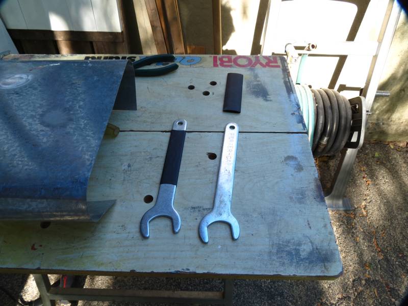

Here you can see the one wrench with the heat shrinking finished and another getting ready for the process.
[ATTACH]22863[/ATTACH]

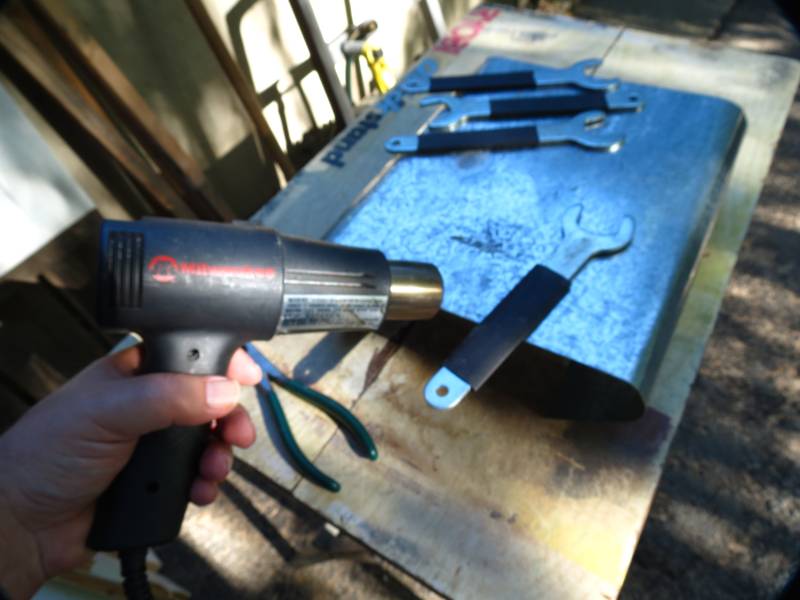

The tubing slips on as shown here.
[ATTACH]22864[/ATTACH]

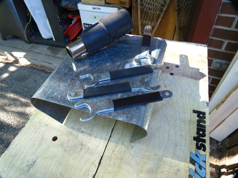

I use a heat gun to do the shrinking. This is not a hair dryer, this thing puts out 1200W and is not a toy but a real heater. I use a pliers to hold the wrench while doing the thin sides first then going back to do the flat sides. You do not want to hold the wrench in your hand until it has cooled.
[ATTACH]22865[/ATTACH]

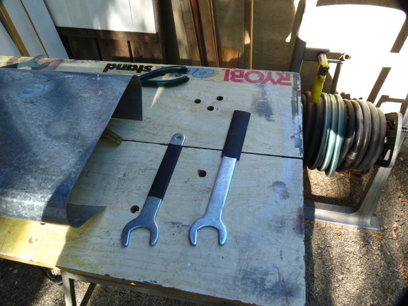

The wrenches pictured are for a couple of 690 Porter Cable routers I have.
[ATTACH]22866[/ATTACH]
