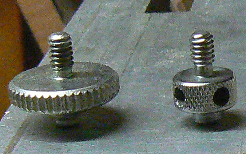

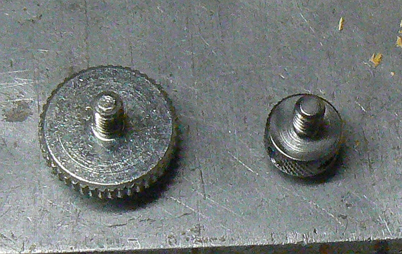

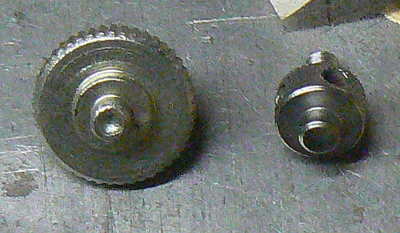

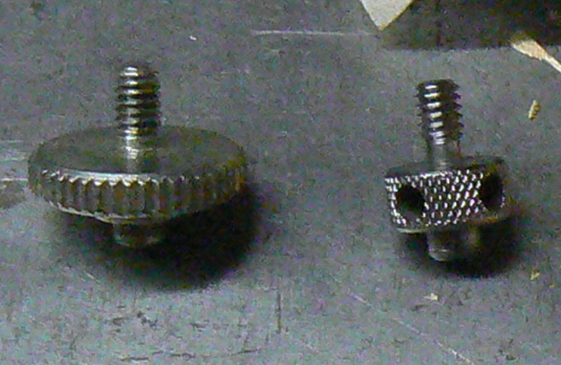

I took this a step further and took pix of the two different jack screws.
[ATTACH]22870[/ATTACH]
[ATTACH]22871[/ATTACH]
[ATTACH]22872[/ATTACH]
[ATTACH]22873[/ATTACH]
- jack screws a.jpg (407.85 KiB) Viewed 1921 times
- jack screws b.jpg (303.09 KiB) Viewed 1921 times
- jack screws c.jpg (320.43 KiB) Viewed 1918 times
- jack screws d.jpg (344.61 KiB) Viewed 1920 times

I have always assumed the newer larger ones were a part of the change that redesigned the tubes.rcplaneguy wrote:Thanks for the info, I did not know 510s had differences in rail mounting/lock knobs!

AHhhh, the memories!JPG40504 wrote:I took this a step further and took pix of the two different jack screws.
