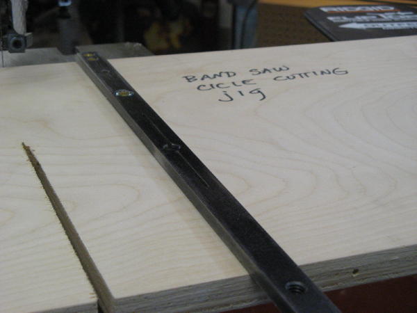

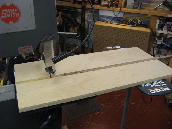

I made one years ago and it works fine. I can't remember where I saw it, but most of them seem pretty similar, IMHO. Not much to mine:
1. there's a bar from an old miter gauge
2. base (scrap pw)
3. slider (scrap hardwood)
4. nail (pivot pin)
5. C clamp (hold the unit on the band saw - not shown in pic)
6. spring clamp (to keep the slider from moving - not shown in pic)
And it's easy as can be to put it on the table and use with the disk sander too. The smallest circle I've made was a 5" diameter.
[ATTACH]22894[/ATTACH]
[ATTACH]22895[/ATTACH]
2. base (scrap pw)
4. nail (pivot pin)
