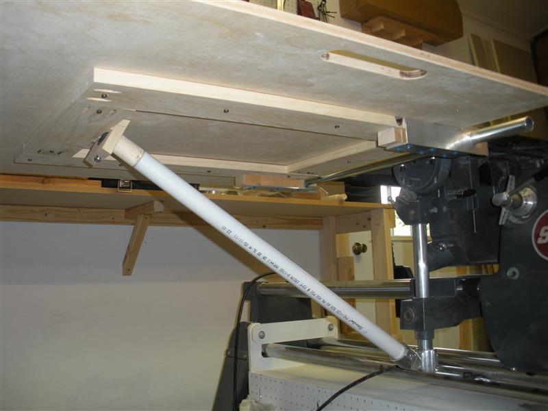

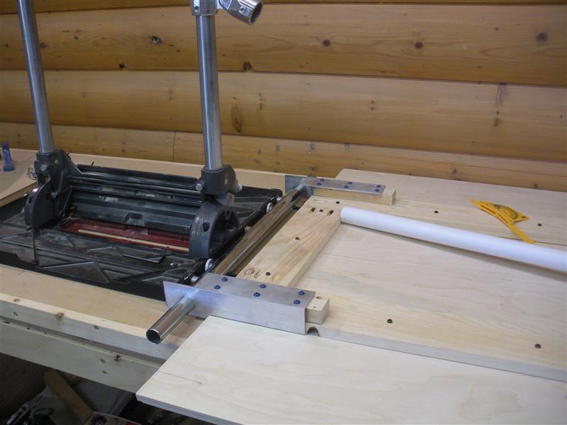

Thanks to Dusty and Claimdude, I now have an OFT for my 510. The OFT is based on Dusty's general design, but his aluminum angle attachment brackets (for a 520) had to be reconfigured to work on my 510. I could not use the open slots to attach to the rails. Instead, I used a closed circle in the attachment bracket, which is a bit more complicated to use, but it does work.
Here are some images.
Basic construction of attachment system:
http://shopsmith.net/forums/attachment. ... 1380722006

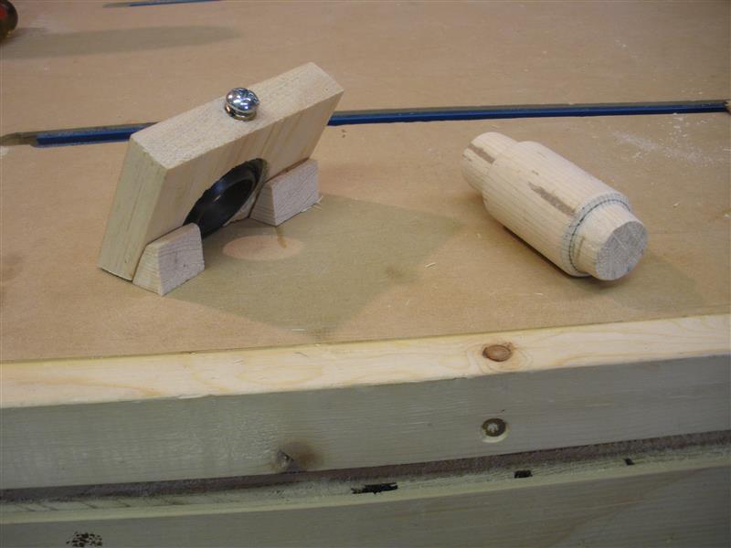

Special parts I had to make (thanks, claimdude, for the ideas for the bearing and the turned piece that connects the support tube to the OFT):
My plan is to wax the surface of the OFT. Anything wrong with that?

Very good adaptation!!

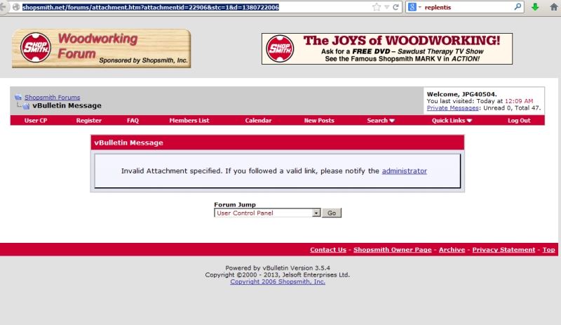

BTW yer post is missing an attachment(the first 'link').
hjlssfor1 wrote:I see that only three images are listed as attachments, but all four images have links in the text, so all images are available. Hank
This is not what I call 'available'.]22921[/ATTACH]
