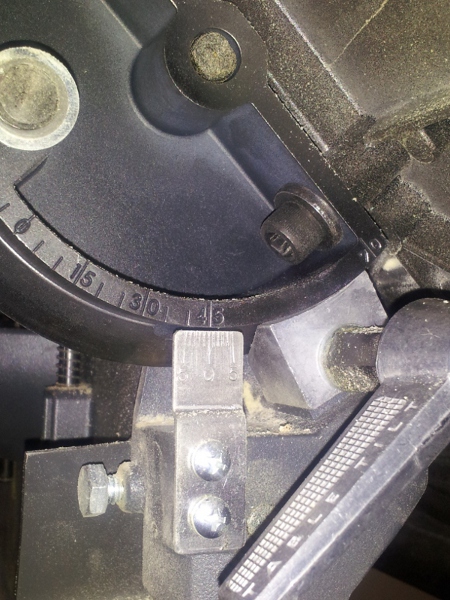

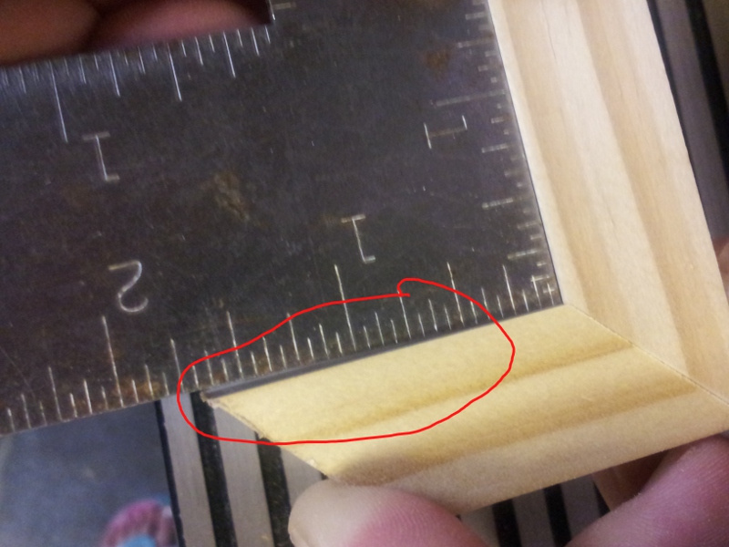

My 12-year old daughter is making a clock (last plan in this book: http://www.amazon.com/Drilling-Project- ... B005CP7SEE ) and I am helping her.
We need 45-degree angles and when I cut them (which was not easy to set up, in my opinion...I must be doing something wrong!) I put the cut-off and the good piece together hoping they will form a 90-degree angle, but they are not perfect.
I am attaching pictures of my table angle setup and one showing the error, circled in red.
Any advice on how to make the angles work or to correct what I may be doing wrong?
- Setup.jpg (179.32 KiB) Viewed 5386 times
- BadAngle.jpg (181.29 KiB) Viewed 5377 times

IF I had ultimate confidence in the table angle scales, I would say you set the table about 1/4 degree off.
However I do not have that confidence in the scales(I am guessing you do!).
Question is, did you adjust the table angle all the way to the 45 degree stops?
I will assume you did.
If so the stops need to be fine tuned. You are very close.
I also assume you have never adjusted the stops.
Btw a 1/16" gap at 1 5/8" is about a 2 degree error which makes the bevel cuts about 1 degree shy of 45 degrees.
This is my first time making a cut like this, so I have not had to use the scales...JPG40504 wrote:IF I had ultimate confidence in the table angle scales, I would say you set the table about 1/4 degree off.
I did...JPG40504 wrote:Question is, did you adjust the table angle all the way to the 45 degree stops?
JPG40504 wrote:If so the stops need to be fine tuned. You are very close.
I also assume you have never adjusted the stops.]
No, never adjusted them...will have to play around a bit with them...didn't really even know they could be adjusted, but now I see they can!
Thanks for the pointers...

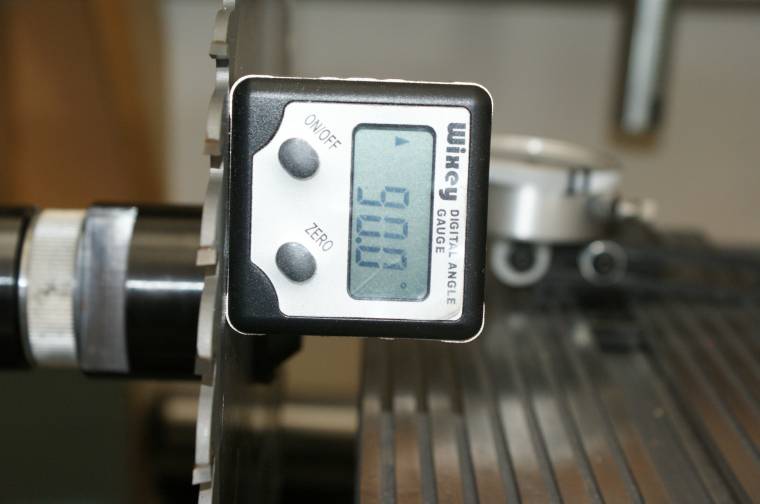

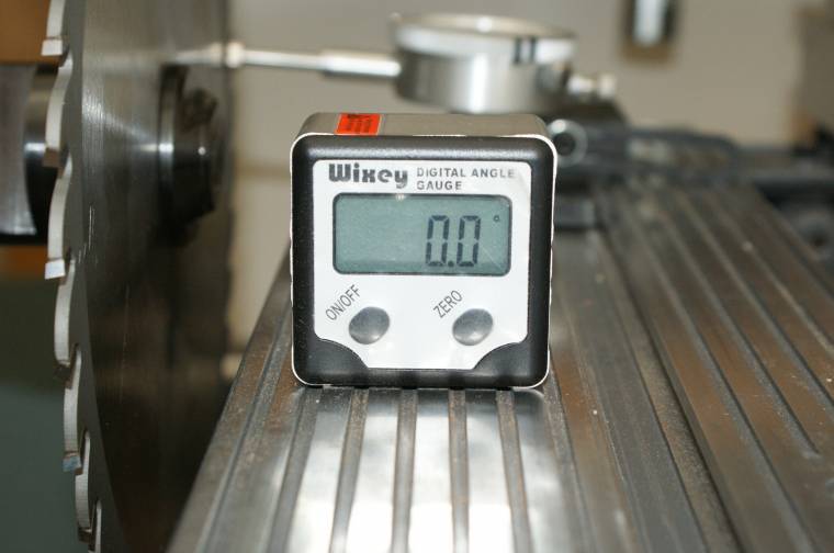

Hi Morgan
If you want to cut very accurate angles you may want to invest in some form of a digital angle gauge such as a Wixie. It can be used to check the angles of setups and also to tilt the table by resting the Wixie on the fence when you set the tilt. There other devices that can be used to set the miter gauge as well
[ATTACH]22924[/ATTACH]
[ATTACH]22925[/ATTACH]
Bill V
Bill V
- wixie on the table.jpg (86.68 KiB) Viewed 5545 times
- wixie on the sawblade.jpg (81.46 KiB) Viewed 5541 times
