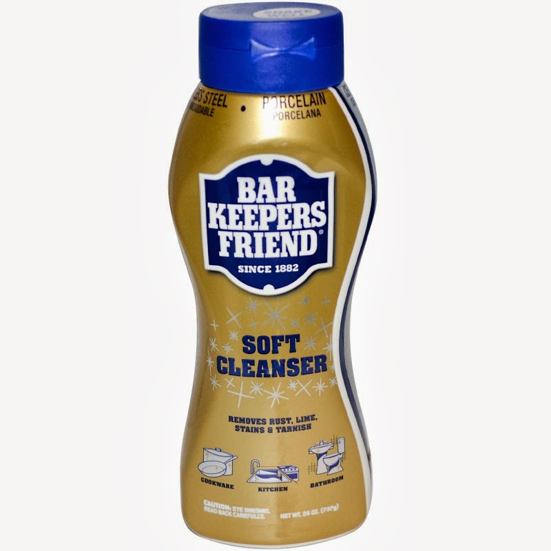

As a newbie to this forum I'm sure I've missed many conversations on how to deal with rust and corrosion on cast iron tables of the jointer, bandsaw, and planer. Also on way tubes, etc. I've tried scotch brite, wd40, boeshield t9, steel wool, etc.
One amazing product I've not seen discussed is Barkeepers Friend:
It is amazing to me how well it works. Follow it up with Johnsons Paste Wax, of course. It brought back my dad's 1986 SS 510, planer, jointer, and bandsaw to looking like new.
Has anyone else tried it?

rcplaneguy
Posts: 549
Location: Chapel Hill, NC
Post by rcplaneguy »
fredsheldon wrote:No, but unless those units all just came out of the original boxes, it must do a good job. I might give it a try.
Fred
This 510 and the cast iron tables had a fair bit of rust/corrosion. The Barkeepers Friend worked wonders, and very fast. If you try it, get the liquid version in the photo above. The powder form is OK but it is harder to work with. Lowes is where I purchased.
