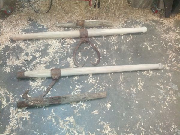

Last week I picked up some 6x6 and 6x8 cedar posts from a friend who owns a Woodmizer. He wouldn't let me pay for them so while we were talking I noticed a log carrier and a cant hook hanging from the rafters. Both handles were rotted away years ago when he found them. So I offered to fix them. He dropped them off Sunday with about four times the wood I needed to turn the handles.
[ATTACH]22970[/ATTACH]
Needed four foot handles
[ATTACH]22971[/ATTACH]
Cant hook or cant dog but not a peavey.

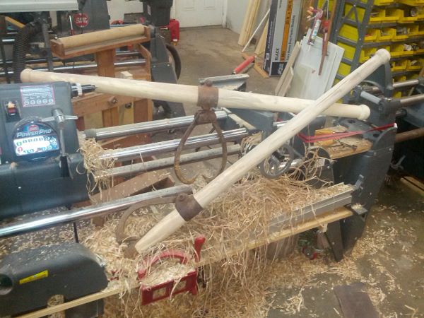

[ATTACH]22972[/ATTACH]

I like your extension. Do you take the project off and turn it around to get the other end. Nice job on the handles.

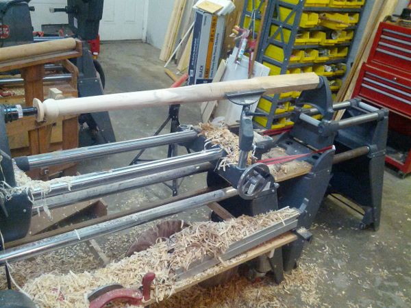

Cant dog handle
I appreciate the kind words. It's nice to know that there are still people who give expecting nothing in return. The extension is a temporary tool storage stand from the leftover 18 inches of my shorty. I cut out a 3/4 inch piece of plywood to match the base assembly ends and held it together with a ratchet strap. As an added bonus the arm lock knobs on the base assembly screw over the top of the plywood holding it down.
The work piece still has to be flipped end for end to finish the turning. If I were to do long pieces often I think another carriage on the extension stand with a connector between the two lathe tool rests would work.
