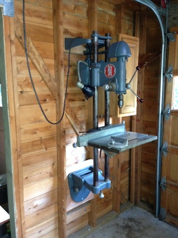

Here are a couple photos of my dedicated 10E drill press that I posted a month or two back in another thread:

Fred, that is a SLICK build. But, why the short base? Semi-dedicated drill-press?
Dgale, how secure is that bolt on the headrest/tiebar? I can imagine it falling, if too loose.

Yes, that crossed my mind - the bolt is plenty tight, but as a safety net, I put a heavy duty zip tie around it to secure everything in place. I don't have any need to lower the drill press, but if for some reason I did (ie had to get the headstock off for servicing), I can just cut the zip tie and loosen the bolt, replacing the zip tie when I put it back up.skou wrote:
