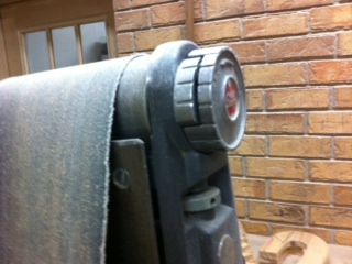

While making "crafts" for an upcoming craft fair I started out with first not being able to get my belt sander tensioning knob to hold and function properly. Then My band saw had the blade keep coming off the front of the upper wheel. New tires on it and has been used for 20-30 hrs. Then the coup de gras, my power plant started giving an error message, "Low Voltage", then System Error, RPS, Error 0" ANY HELP WOULD BE GREATLY APPRECIATED AS I AM IN A TIME CRUNCH, OF COURSE.
Photo of belt sander tensioning knob.
- Belt sander tension knob.JPG (34.61 KiB) Viewed 1591 times
0) Remove belt.
1) Release any remaining tension - Hold the idler drum with one hand, depress the catch with the other. Allow the knob to rotate CLOCKwise until the catch stops it. Repeat until all tension is removed(until knob will not turn when catch is depressed).
2) Set tension - While still holding the idler drum, turn knob COUNTERclockwise 4 revolutions(catch drops fourth time).
The arrows on the knob can lead one to do this incorrectly. i.e. human factors 'suck'!

I think the directions for adjusting the belt sander are somewhere in the "Sawdust Sessions".
I'll look for where, but maybe someone else can find the instructions faster than me. JPG always remembers this stuff! Good for him! Beat me to it!
