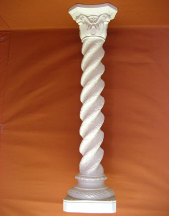

A friend is redoing a stair case and has decided instead of making flutes in the pilaster she would like a spiral one, sort of like this
[ATTACH]23063[/ATTACH]
Setting up the SS to do indexing with fluting seems plausible, but anyone tried to create spirals? I've seen the small ones made on the band saw, but somehow I think a 7" thick chunk of wood is not going to be that easy to manipulate on band saw table. especially tilted! :eek:
I've also seen ones made using an expensive machine that moves a router along a path as the wood is rotated to make that spiral. Way too pricey and not something I have a desire to add to the shop.
Before I simply refuse, I have no real clue where to start!. has anyone successfully made something on this scale? 4 foot high 7 to 10 inches diameter.

The picture is of one made using foam, so I "could" use it with a solid core for mounting and then paint it. That's might current fall back position.
