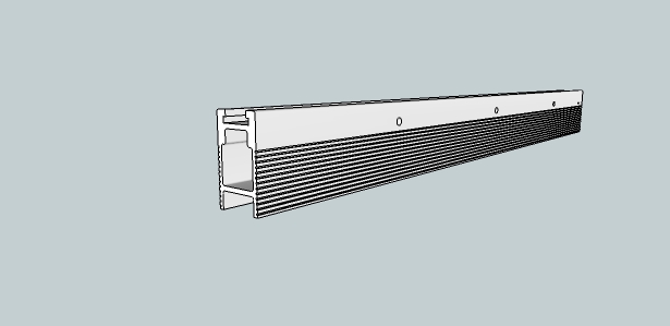

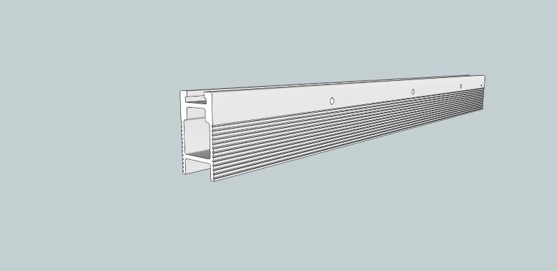

[ATTACH]23079[/ATTACH]
I have (at least for the moment) found a solution.
Now, if only I could attach the SKP file from Sketchup.
I have, however, placed this file in the Sketchup 3D Warehouse (Now more properly referred to as the Trimble 3D Warehouse).

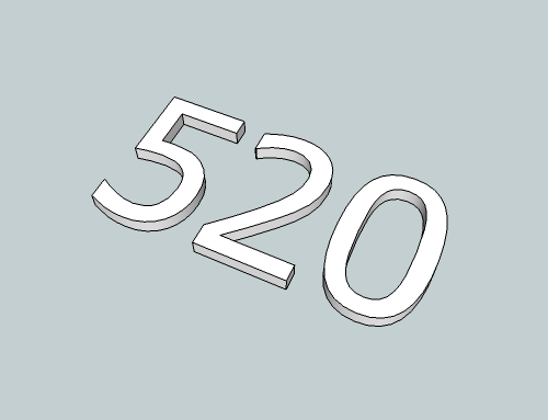

Maybe I misunderstand, but here's a PNG right from SketchUp (free version)
[ATTACH]23080[/ATTACH]

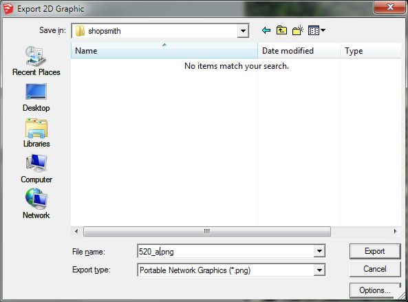

In the EXPORT 2D dialog, click on options at the bottom right, after selecting PNG from EXPORT TYPE:
[ATTACH]23081[/ATTACH]
[ATTACH]23082[/ATTACH]
Here you can save any size you like

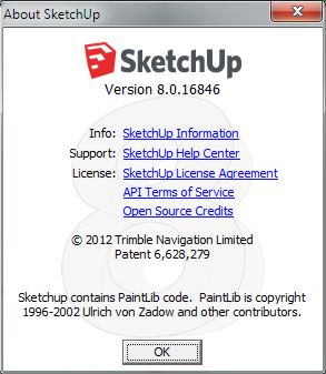

VERY INTERESTING.
I'll go, immediately, to see what I have been missing. You may be using a later (or different) version of Sketchup OR I am missing something.
[ATTACH]23084[/ATTACH]
I have been unaware of that feature FOREVER. I guess it was always right there in front of me. Thank you so very much.
