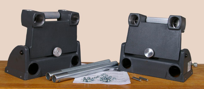

I ordered my Lift Assist in June and it arrived yesterday. Wow does it make a difference for an old fart with no arm strength and less balance!!:rolleyes:
However, I remember reading about the problem with the mounting brackets interfering with the Universal Tool Rest. Before I received it I began wondering about making a bracket that would attach to these
\/ \/ \/ \/ \/ \/ or the swivel base on the 500
[ATTACH]23091[/ATTACH]
rather than clamp on to the tubes. Could it even be plausible?
My thoughts are to fabricate some sort of angle iron brackets that attach the existing "J" arm and ball socket pieces that come in the kit. Really only eliminating the clamps that go on the tubes. Some drilling would be required, but angle iron on the back side also for strength so the bases don't have to absorb all the shock, stress.
Before I butcher anything (and thereby VOID ANY warranty) :eek: , in the estimation of those that are using the UTR, would eliminating the mounting brackets from the tubes. be of any real use, help viable / measurable benefit?
BTW, when I talked to CS about this, no one had ever heard of the powers that be, trying to change the mounting method, so maybe it isn't that big a problem???:confused:
Input, advise and other bits of wit and wisdom requested.
Be well,
Ben
Recommend installing the lift exactly as detailed in the instructions. Later, if you need modifications then do some thinking.
I would have to agree with Charlese. I believe you need to install it as designed and use it for a while before you conclude that it needs to be "fixed".
I have had mine for three or four years and have no complaints. If I had cabinets to put under the Mark V or if I was a turner, I might not say that.

I installed my lift assist per plan. When turning I found that I couldn't get close to the tail stock when working small objects. But instead of changing the mount on the lift assist I ordered a tailstock extenter, with a #2 morse taper. It moves the live center to the left far enough that the brackets don't interfere with mounting anything in the tailstock. I've never had issues with the universal tool rest in this set up.
fredsheldon
Posts: 1175
Post by fredsheldon »
I found I had to install 2 tailstock extenders to be able to fit between my large bowls and the live center. I was thinking of even adding a third one to see if it's still stable. I also ride the base up and over the bracket to gain another inch or two, works great.
