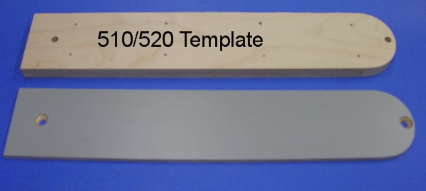

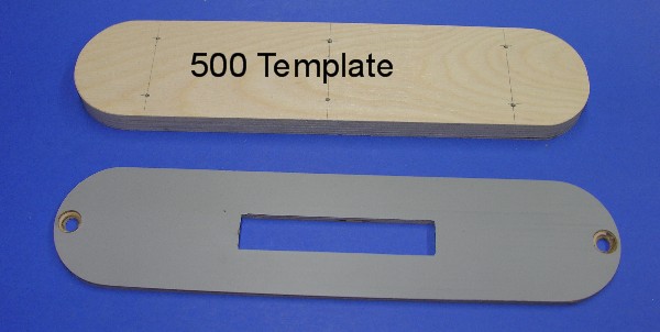

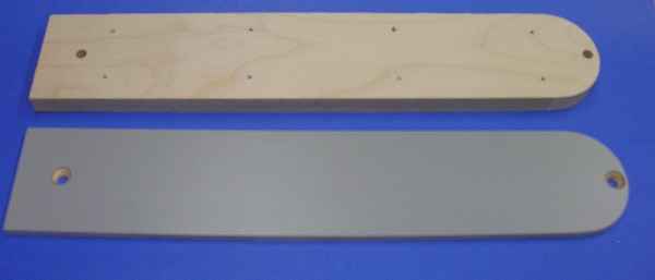

ldh
Posts: 430
Joined: Sun Sep 10, 2006 6:09 pm
Location: Phoenix, AZ
Post by ldh »
alaskanexile wrote:The table saw insert on my old 56 500 had a rather unhandy bow that made it high in the center. When I tried to straighten it it broke. That made the situation considerably more unhandy. Ordered a zero clearance insert blank from SS, but as mentioned earlier by someone else, the manufacturer has been turning them out 1/8th inch too short. That too is a bit unhandy. SS intends to replace it with the correct length when they come available. In the meantime, I have made a couple out of 1/4" mdf which works OK but is a tad too thick so had to be sanded down. MDF also is not all that slick so provides some resistance to stock being slid across it. Those of you that have made your own zero clearance inserts, what do you make them out of and where do you get it?
Roger
Roger,
I use 1/4" baltic birch ply and I laminate it with formica. I made a template from 3/4" baltic birch of the factory insert (this must be accurate) and placed a few sharp points (nails or drywall screws) to hold the 1/4" blank in place while I routed it to the template with a trim bit. You can get a nearly perfect fit by sanding the bottom of the insert or adding a bit of shim tape depending on which it needs. I found the I rarely need much change when I am finished as the formica seems to bring the 1/4" baltic birch to the right thickness. I added a couple of pics of the template and some finished inserts.
I hope this helps.
ldh
