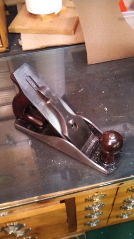

Well I have a number of you to thank for recommending to me Evaporust, rust remover. I had this old Stanley #4 in a box of stuff "To Be Restored". The body was covered in rust and it had a tag that indicated I picked it up for $5 at some junk store. I have a hard time turning my back on these old work horses, but I kept putting off cleaning it up because my old methods, before Evaporust, were so time consuming (WD40 and wire wheels).
One of these days I will remember to take Before pictures, but it slipped my mind. It's more fun snapping the After pictures.
[ATTACH]23256[/ATTACH]

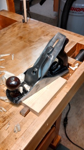

The handles were all crazed. Beginning in 1942 Stanley moved from Rosewood to hardwood, and the old finish was shot. Using a French wheel I removed the old and refinished in a dark mahogany the way they came. Another clue that this plane dates to 1942-1945 is the brass was replaced with a hard rubber adjustment knob and cast screws for the handles.
[ATTACH]23257[/ATTACH]

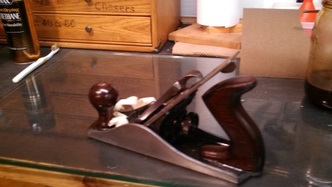

I flattened the sides and bottom using the SS sanding disk and finished them on sandpaper on a glass plate. Most of the original japanning (black paint) was intact, but touched-up some spots. Reground the blade. After waxing the body and assembly, it took a fine shaving. Another oldie saved from the trash bin.
[ATTACH]23258[/ATTACH]

Hey guys, first thanks for the "at-a-boys" on cleaning-up this plane. It's good for the old ego! I really do kick myself that I didn't take some before pictures - it was pretty sad. I'll tell you, I had a gallon of Evaporust in a bucket working on my sump pump when I came across this #4 while looking for something in my shop. I quickly took it a part and dropped it into the bucket for several days. It came out looking good and wire brushed it. The rust had pitted the bottom and sides, but nothing around the mouth. The pitting is one reason I sanded it using my SS disk sander first, hitting it with a heavy grit. I didn't get it all out, but it doesn't effect use.
Studying my type books (thanks for the web pages, I've never used the web pages before. Good to know they are there) I've concluded the plane has a bastard lever cap. It seems to be older than Type 12 (older than 1919). It doesn't have Stanley cast across the front, does not have the kidney shaped hole, and has a shorter leaver. The blade, frog, and all other parts appear to be Type 17. Of course this is all "inside baseball" stuff, fun but not necessary to woodworking. However, if you are going to use old tools I have found being an archeologist a hoot.
