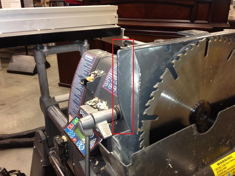

One thing I noticed about the lower saw guard Bill was using on his Mark 7 was that it has a front-facing flange that my lower saw guard does not have. Here's the picture Bill let me take.
[ATTACH]23263[/ATTACH]

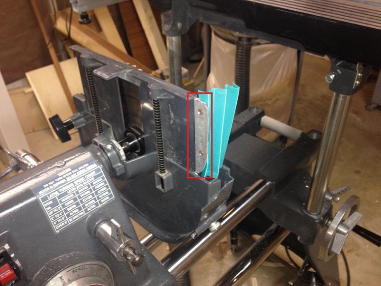

My circa 2001 lower saw guard definitely does not have the piece outlined in the red box in the above photo. Bill did not know when the change was made or why. I'm sure I only noticed this only because I have been working recently to improve dust collection and I had to build and attach a piece out of angle aluminum to attach my dust deflector as seen in this picture:
[ATTACH]23264[/ATTACH]
Does anyone have a lower saw guard that looks like the one in the first photo?

I believe this design was quietly changed. See this photo of the lower saw guard on the Shopsmith site: http://www.shopsmith.com/markvsite/imag ... access.jpg
I believe this change will stop some dust from escaping to the head stock side but still not impede the vast majority of dust ejected straight forward over the opening between the table and the lower saw guard without some additional barrier/deflector.

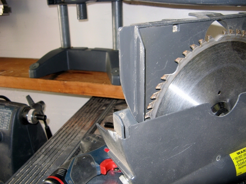

This may help narrow the saw guard change by a couple of years.
[ATTACH]23275[/ATTACH]
[ATTACH]23276[/ATTACH]

Yup. Thanks. Between 2001 and 2003.
