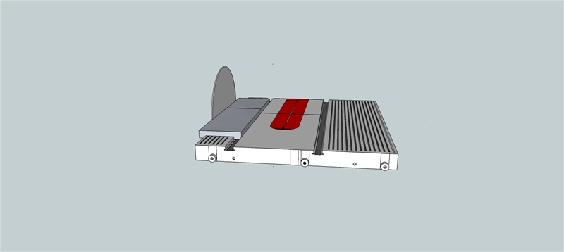

I am sensitive to the impact that the teeth would have on alignment.
Yes, Shopsmith obviously did not intend for the edges of the table to be used as a reference surface. It is a shame, really, because it would have been so easy to do so during the milling process.
There is something like this in my near future for use as a reference surface (positioned by a miter track). This would be precision milled and referenced off the miter track. While I wait for my turn at the mill, I'll probably do one of these (proof of concept) using MDF .
My oldest grand daughter's husband is schooling to become a machinist. I have a list if projects that I have offered him for the "learning experience". This is one of them.
[ATTACH]23334[/ATTACH]
Note: If you own a Tenon Master, take it apart and look at what you have. A milled steel plate attached to a short piece of miter bar. This two piece assembly is somewhat adjustable (loosen the two screws and play with it. You will find about .003" of slop in the miter track. With that in mind, it is a perfect "feeler gauge" for table to blade verification. Works just like the miter gauge with a rod for the feeler.
The rest of the tenon master, the face, is a perfect square surface that can ce used to set the table tilt to 90° to the blade. An excellent tool that has been gathering dust in my shop because I usually cut tenons on the band saw.
[ATTACH]23331[/ATTACH]
Now that is a snazzy idea! I love it. Let me know how ours turns out.
