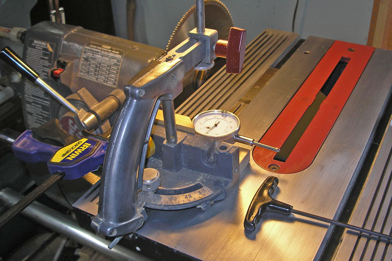

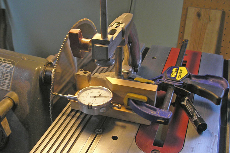

Almost a trivial little gadget but here goes. I recently bought an inexpensive dial micrometer from Harbor Freight ($20 or so and works quite well) and I wanted a simple way to mount it (using the miter gauge slot) and use it when aligning my 510 and (ta-da!!) my 520.
[ATTACH]23380[/ATTACH]
This is my rather simple little wood bracket I built to hold the dial micrometer. I opted to use the miter gauge itself and I just clamp my little assembly to the gauge.
[ATTACH]23381[/ATTACH]
You can just flip around the miter gauge to measure on the other side.

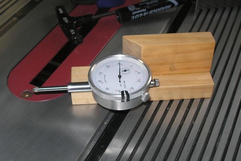

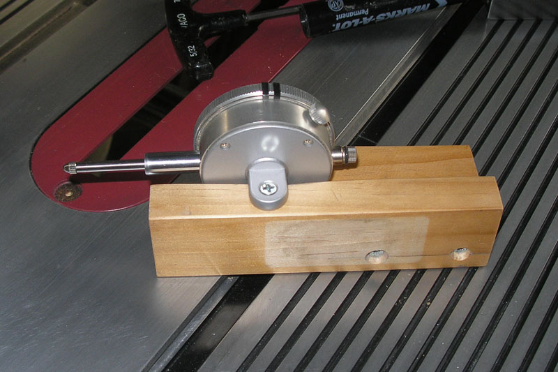

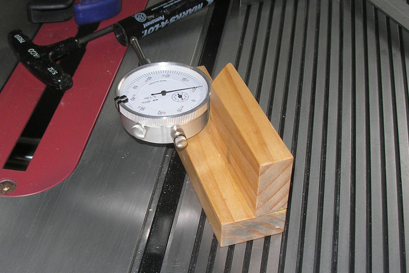

And here are two shots of the simple mount - just cut a piece of 1x2 pine, a bit of gluing, sanding and a quick coat of shellac.
[ATTACH]23384[/ATTACH]
[ATTACH]23383[/ATTACH]
Eventually I'll probably eliminate the need to use the miter gauge. Maybe. Or just leave it alone! It gets the job done.
[ATTACH]23382[/ATTACH]

That looks to be a real neat solution to a common task. How much deviation does the miter bar create? I would guess about .005" which is really negligible.bobgroh wrote:Almost a trivial little gadget but here goes. I recently bought an inexpensive dial micrometer from Harbor Freight ($20 or so and works quite well) and I wanted a simple way to mount it (using the miter gauge slot) and use it when aligning my 510 and (ta-da!!) my 520.

I've just started playing with it - the table itself hasn't been aligned at all although the overall deviation along the saw blade is 15 thou or less. I have always wondered how flat a saw blade is, etc. Now I can play around a bit and see! But first I need to get some other work done and then I will mount my 'new' 520 table and get it aligned. And check saw blades and the sanding disks for flatness and a few other little twitches. I've been seriously thinking about picking up a Wixey digital angle gauge for aligning things also.dusty wrote:That looks to be a real neat solution to a common task. How much deviation does the miter bar create? I would guess about .005" which is really negligible.
