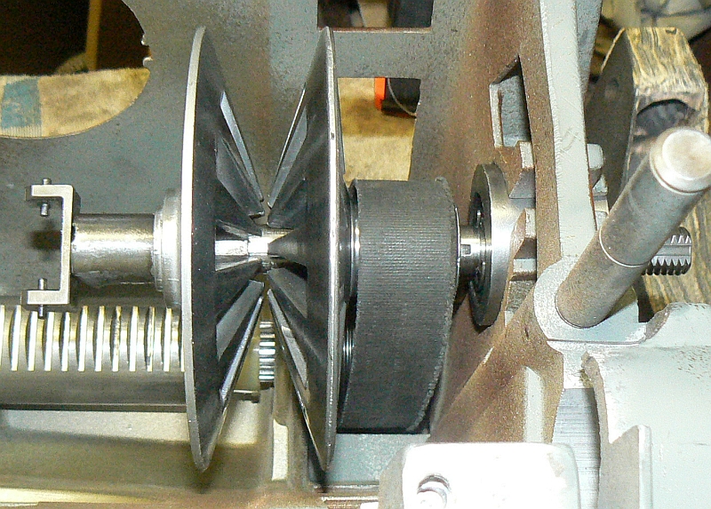

Here is what the follower looks like.
the thing on the left center of the picture.
it is the rectangular thing with pins and spins on the center of the sheave.
Sent pm.

I believe I used the Mark V Control Sheave and Idler Sheave on the Mark VII idler shaft. I machined the Mark V Control Sheave bearing depth another .050" deeper so I could stake the bearing with the Mark VII speed cam follower. I would be happy to try this change if you wished to mail me the Control/Idler sheave and shaft assembly. I have a metal lathe so have been able to even machine collars to go over the Control Sheave end to hold the bearing. I have a hydranic press I used to press together this collar and Control Sheave. Contact me off-line if interested.

I had a M5 control sheave become so badly worn to allow it to 'skip a vane' and become jammed. The key way was also severely worn. Yes too little tlc and lubing over almost a half century.
I would also replace the key as a minimum and both sheaves as I am sure Bill will Recommend.
New bearings at this time would also be in order.
A 'permanent' solution to your plastic cam exists, although it is not inexpensive. If 'he' does not offer you an aluminum cam, I will PM you with his 'nom de forum'.
P.S. Notice I also had a problem with the control sheave 'snout' retaining the bearing. Notice the jb weld in 'our' pix you posted. ;>}
