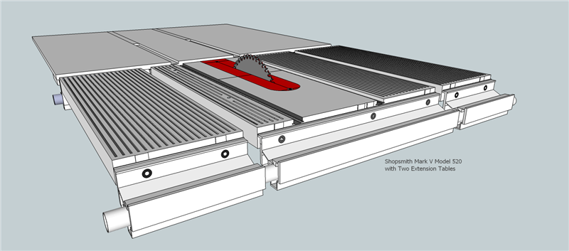

It has been said by some naysayers that the Shopsmith table is too small. While it is not as large as some, it need not be considered inadequate. With the simple addition of a home built outfeed table and the utilization of two of the extension tables one can easily have a table top that is 34 1/2" x 55".
[ATTACH]23423[/ATTACH]
Add to this, a Sliding Cross Cut Sled and you can be ready for just about any home shop wood working project imaginable. Well, for the turners out there that is not a true assessment but the Shopsmith solves that problem too.
- Main Table with Two Floating Tables and New OFT (Dec2013) (Custom) (2).png (127.38 KiB) Viewed 3729 times

IMHO - this is all fine and dandy IF what you want is a table saw.dusty wrote: With the simple addition of a home built outfeed table and the utilization of two of the extension tables one can easily have a table top that is 34 1/2" x 55".
However what I want (and Love) is a Shopsmith multi-purpose tool that is easily and quickly convertible to other uses. Doesn't this table configuration hinder other operations?

charlese wrote:IMHO - this is all fine and dandy IF what you want is a table saw.
BTW - It doesn't hurt (or even touch) my sensibilities to say that my saw table is too small.
I don't think so but that depends on what is considered a hindrance. The OFT is easily removed (just hangs on the tubes). The extension tubes may need to be removed but that is standard Shopsmith. The extension tables get set aside. I am now in a standard Shopsmith configuration.
