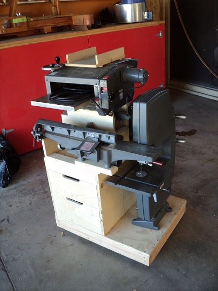

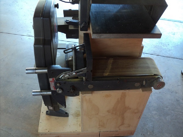

- shipwright
- Posts: 1165
This is my tool cart. It takes up very little more room than a pro planer and the planer is at waist height. This sort of thing may suit your needs.
[ATTACH]23439[/ATTACH] [ATTACH]23440[/ATTACH]
- DSC01086.JPG (104.55 KiB) Viewed 11961 times
- DSC01089.JPG (93.77 KiB) Viewed 11955 times

Excellent design and very compact! Do you still have the plans for this roll around SPT holder unit?shipwright wrote:This is my tool cart. It takes up very little more room than a pro planer and the planer is at waist height. This sort of thing may suit your needs.
I would love to make a similar build down the line. I love that 4 major SPTs fit on it in a organized and compact manner allowing each one to be easily removed for use on the shopsmith!
Cheers,
John

Thanks and sorry, but I never had plans. I just made it up as I went along. I still use it and it is still very handy even though I have changed shops to an even smaller space. Do you have the same SPTs that you want to mount? I could take some measurements for you.
Re: Plain -- er -- Planer questions
I have the exact same SPTs!shipwright wrote:Thanks and sorry, but I never had plans. I just made it up as I went along. I still use it and it is still very handy even though I have changed shops to an even smaller space. Do you have the same SPTs that you want to mount? I could take some measurements for you.
I would very much appreciate that and my back would as well!
Cheers,
John
