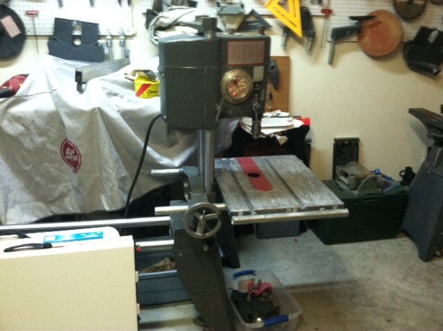

Will it work and has any one else ever tried this idea ?
[ATTACH]23526[/ATTACH]
To reduce floor space and make a smaller foot print can you reverse the table and motor and put them on the inside ? I know you won't be able to lower the unit but it is a dedicated drill press shorty for now .
Is it total nuts ? :rolleyes:

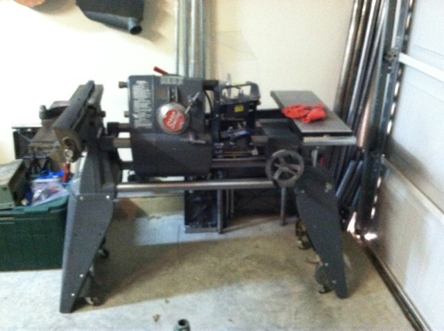

My new shorty ! Dedicated to the ringmaster.
[ATTACH]23528[/ATTACH]
Trying to make space for all 5 of my Shopsmiths. Rule is wife's car must be in garage at night. :)

I think ya can do that, BUT you's dave to straddle the tubes to use it.
2centsworth wrote:Will it work and has any one else ever tried this idea ?
Yes, the carriage and headstock can be rotated 180° on the tubes. I have had mine that way. It did not stay because the horizontal tubes were in the way. If I could throw a leg over the tubes and sit it like a horse, I might have done that but those days are history.
If you did that, you'd want to reinforce the sitting area. Well, maybe not. You are likely not as heavy as I am.
If you really need to clear out space, I could give you a shipping address where there is available space.:rolleyes:

2centsworth wrote:My new shorty ! Dedicated to the ringmaster.
If you want to keep it as a dedicated drill press, reverse the headstock and carrige and go to 12" bench tubes. This really makes a nice roll around drill press and any function that you can do in the drill press position. Later, I removed the legs, bench tubes and headrest and then bolted the base using longer studs in place of the bench tube bolts to a metal stand with large casters. This is now my drilling, tapping and milling Shopsmith. I also have a table top 4" belt sander, 8" polisher with 8" wire bushes and a 6" grinder on this stand that takes about the same floor space as the 12" Shopsmith setup did.

billmayo wrote:If you want to keep it as a dedicated drill press, reverse the headstock and carrige and go to 12" bench tubes. This really makes a nice roll around drill press and any function that you can do in the drill press position. Later, I removed the legs, bench tubes and headrest and then bolted the base using longer studs in place of the bench tube bolts to a metal stand with large casters. This is now my drilling, tapping and milling Shopsmith. I also have a table top 4" belt sander, 8" polisher with 8" wire bushes and a 6" grinder on this stand that takes about the same floor space as the 12" Shopsmith setup did.
Bill I can use the short tubes I cut off already. Fantastic !

Is there any difference in the size of the tubes once cut ? I know the bottom tubes need to be 3/4 inch longer then the top - but does that still hold if shorten to 13 inches ?Thanks
Jerry Penny
2centsworth
The Woodlands, Tx
SS 520 SN#518424 2000 (reversed motor), Shopsmith 10 E (shorty) fully restored by Skip with DC motor, Shopsmith 10 ER fully restored by Skip with DC motor, Shopsmith 10 ER (under going restoration), Greenie Shorty sanding station, Greenie Mini jointer station, SS Bandsaw power station, SS Planner, SS overhead pin router, SS Belt Sander, SS Strip Sander,, SS Jigsaw, SS Dust Collector, Ringmaster, and still having fun looking for more !
2centsworth wrote:Is there any difference in the size of the tubes once cut ? I know the bottom tubes need to be 3/4 inch longer then the top - but does that still hold if shorten to 13 inches ?Thanks
Yes! 3/8" longer on each end!:D
