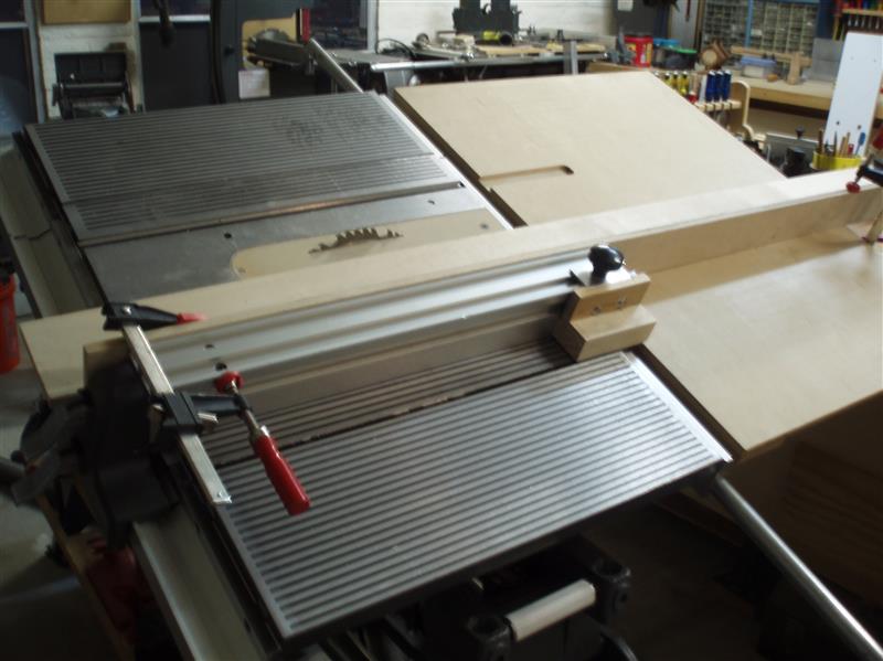

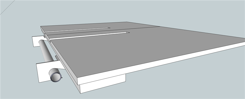

Have you browsed through this forum for information on Outfeed Tables (OFT).mountainbreeze wrote:Interesting how tilting the outfeed table is accomplished. Seems simple.
There are several and some of them tilt with the Main Table because they are attached to the rear table rail.

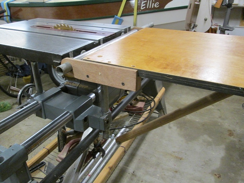

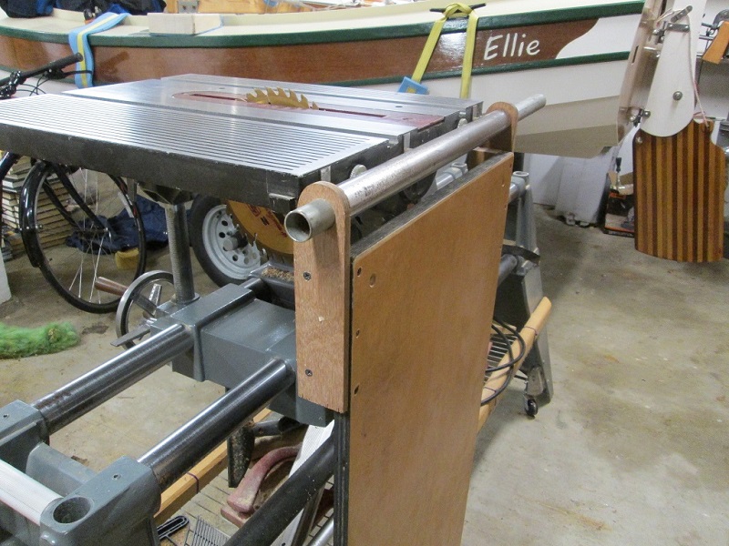

I've made some changes to my outfeed table since I wrote that blog post. I got tired of having to adjust the outfeed table every time I raised, lowered or tilted my 510 table. My outfeed table is now very similar to the one Dusty has, and recommends. It works much better and now requires no additional adjustments. It's also easier to remove, and rarely needs to be removed.

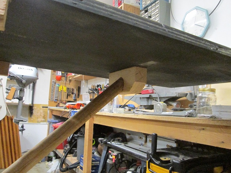

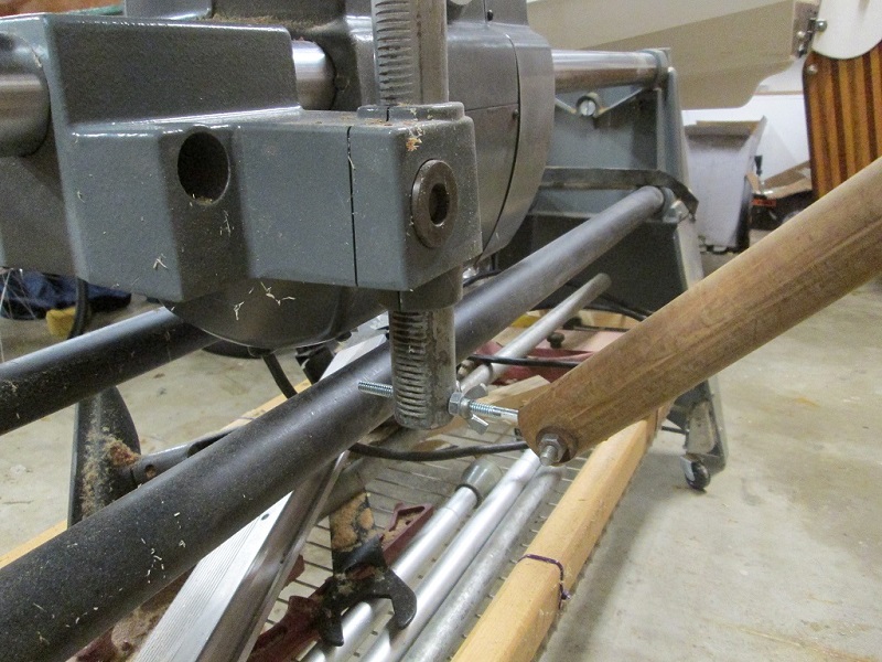

The changes I made were that I did away with the brackets, bolts and wing nuts and instead, attached some pieces of 1/4" ply to the sides of the table with holes drilled to match my 510's tubes. To attach the table I simply slide a tube through. I rarely remove the outfeed table any more. When not in use I just remove the support leg and let the table hang. I also did away with the old two-piece support leg, hinge, bolt and clip and replaced it with a single fixed length dowel. The lower end of the dowel is slotted for an eye-bolt which goes through a hole drilled in the table upright. A nut on the eye-bolt provides fine adjustment for leveling the table (which only needs to be done once). The upper end of the dowel has a "ball and socket" joint to allow the table to rotate. To make that I rounded over the end of the dowel and it fits into a corresponding hemispherical hole in a wooden block attached to the underside of the table.
