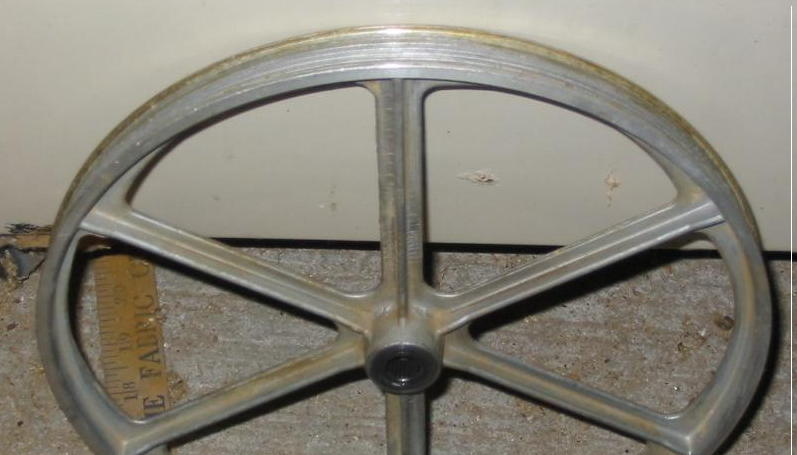

I corrected the tracking but noticed that the lower wheel did not have a tire on it. There were no indications that there had ever been a tire on the wheel.
No old pieces or rubber or anything.
The wheel had two raised areas at the outer edges and resembled a bicycle wheel without a tire on it.
Was this normal construction for bandsaws from this time period or is there really a tire missing.
I don't recall ever seeing a bandsaw af any kind that did not have a rubber tir on both wheels.
Isn't a tire necessary to prevent damage to the sawblade?:
Also this is the drive wheel that receives power from the headstock so it seems to me that the rubber tire is necessary to prevent slippage.

I'd sure like to see this wheel. I've never seen a bandsaw wheel with the raised edges that I envision with this description.wa2crk wrote:The wheel had two raised areas at the outer edges and resembled a bicycle wheel without a tire on it.
Bill
Any chance you could post a photo?
This is a Shopsmith bandsaw - right. I don't believe that was ever so stated. I just assumed ( ass u me (d)).
My Magna bandsaw has the raised edges on the wheels. The urethane tire thickness is greater than the edge height though.dusty wrote:I'd sure like to see this wheel. I've never seen a bandsaw wheel with the raised edges that I envision with this description.

All the Shopsmith bandsaw wheels have the raised edges.
Bill Mayo
Bill Mayo
- IMG_0778.JPG (44.76 KiB) Viewed 11560 times
