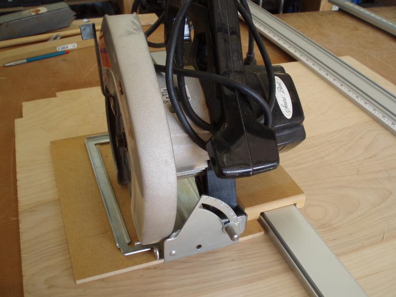

I have a trac saw too. I really like the price tag on mine and it works pretty good even if I have to say so myself.
P8100006 (Custom).JPG (57.21 KiB) Viewed 5846 times

Dusty;
I "REALY" like your version. I have the same saw and use the clamp straight edge just guiding it myself but yours looks like a much better system. I will have to try that approach. Thanks for showing it.

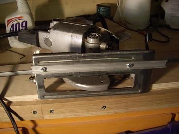

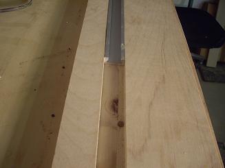

Here are a couple pics of my "track saw".
I just laid in a t track in some 3/4 ply, 8' long.
[ATTACH]23695[/ATTACH]
Then attached the matching t track insert on my Skil 77.
[ATTACH]23696[/ATTACH]
The first cut establishes the cut line so that it can be aligned with the penciled mark at each end of the cut. I allowed 1 1/2" of ply on the side opposite the cut line for clamping.
I fully intended to make a short version, just haven't done it.
This jig is accurate to the point that pieces can be cut to finished size.
Gene
