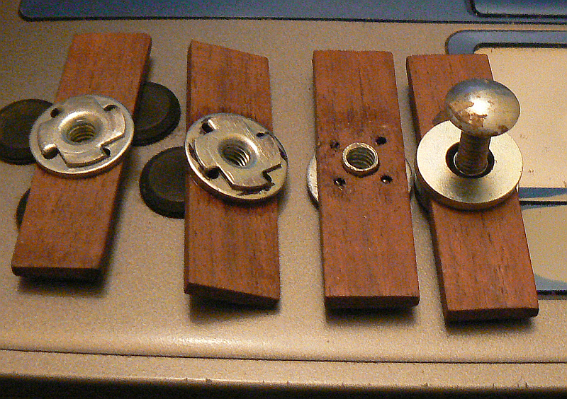

Make some. Hardwood and either tapped or a t-nut.
Add a 'drilled washer' to the parts list!;)
[ATTACH]23708[/ATTACH]
- tnuts ala jpg.jpg (484.2 KiB) Viewed 5517 times

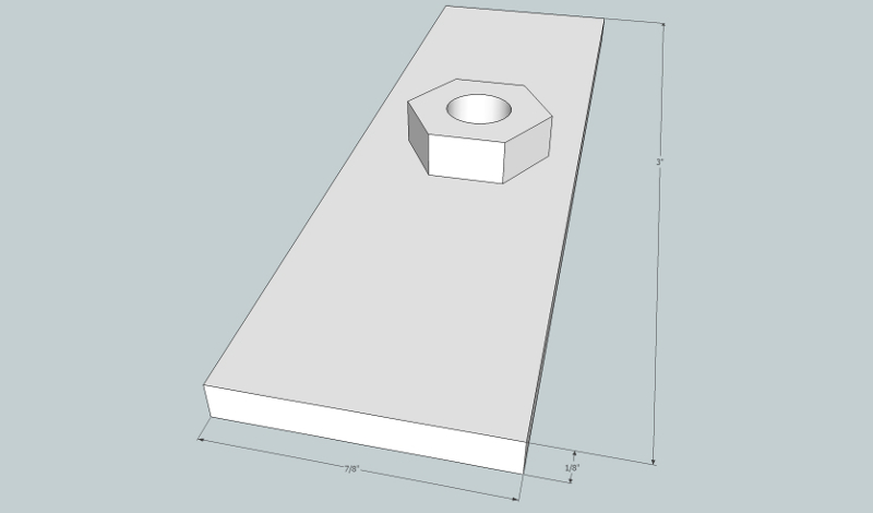

My version of the Sliding T-slot
Besides being cheap, why did I start this? I bought the Shopsmith version of the Kreg bandsaw fence. I did NOT buy the fence resaw guide from Shopsmith
. Since the Shopsmith fence is NOT Kreg's the Amazon purchased genuine Kreg guide attachment holes do NOT line up
. I knew I would have to drill new holes amd buy sliding T-lot thingies, but rather than spending $11 plus postage for the T-slides, I figured I'd just make a custom sliding T-nut for that guide. Then I started thinking (yes I know that's dangerous!! You've all told me that before
) how much it would be nice to have CHEAP permanent t-nuts for jigs yet born. I find that I have a want for large quantities of the sliding T-nuts, however at over $5 a pop (and me being danged cheap ) I thought there had to be a better way.
I've just (Wednesday) ordered 12 feet of 1/8 x 7/8 cold rolled steel (3 four foot pieces) for $20 (Ebay) I had asked a local supply house but they call it a special order meaning LARGE amounts of cash especially shipping.
-Cut the metal bar into approximately 3" strips. Probably narrow each end to facilitate use (though that isn't shown on the drawing)
-Drill a hole with a diameter larger than the bolt to be used, but small enough that the nut can still set firmly on the flat surface.
-Epoxy appropriate jam nuts 1/4 - 20, 3/8 - 16 (jam nits are thinner so should allow clearance without grinding the top surface). Thread the jam nut far enough so that enough bolt will protrude through the strip such that you can get a nut on the opposite side to ho center the nut and hold it while the epoxy sets (or if you are really ambitious I guess you could spot weld it!)
-I will paint each one with epoxy paint to prevent rusting. A different color for each size
With more than 40 I should have enough for any jig, fence and whim until June

I'll make a few with nuts on each end, utilizing set screws and attach a solid 3/16" metal bar in the middle to use magnetic clamps on Magswitch and similar devices. Move the bar in place and set screws to push until the bar is snug enough not to move. I might have to grind down the top surface a 64th or so to get a flush fit. Nope, no drawing, Just close your eyes and imagine!
I know I could have used aluminum for the bottom bar but as long as i smooth (round) the ends and edges of the bar I don't think they will gall the table slot. I considered buying 1/8" x 1" and sawing / sanding it to exact width to fit the miter slot (and maybe for some jig I might), but simply, I figured that a little slop (3/64" if my measurements are close) was no big deal. I was using the bolt and threaded knob to snug the bar UP to the bottom of the slot.

I've come to understand that my design process is to use as many steps and parts as possible to increase the complexity and failure rate(s), THEN start eliminating the not needed until the simplest reveals itself.
Hot rolled and cold rolled would have both been a special order through a local supply house. I found the bar on EBay for signicantly less than what the local supplier quoted (much less than half with shipping), so ordered it. I did consider aluminum. In fact it was my first choice. The local HD has 1/8" x 1" so it would be easy to trim to size, but most interested in having the bulk be steel so I can use the Maglock pieces I have for my table saw to supplement SS fences, etc.
As a steel assembly, I could tack weld, however the epoxy I have for metal has 2500 psi holding on clean aluminum (presume steel is reasonably similar) which works out to about 300 psi for the surface area of one side of the nut. Hopefully that will be enough. I'll build a few and test. If it happens that the epoxy is not strong enough then I'll pull out the welder.
Hoping for warm weather when the steel comes so that I can cut the bars to length and drill them. Right now it is 45 degrees here. Warmth in Montana in January! Who'd a thunk it! Handling freezing cold steel in a freezing cold garage is definitely not high on my list!

My 'thinking' was that tapping through both 1/8" bars would yield 1/4" of threads(5 full threads rather than 2 1/2).benush26 wrote:First mental design was exactly that. Then I realized the thickness of the bottom piece was of more concern to me than the portion that fits in the miter slot. The next thought was that it would be much easier to buy nuts and glue or weld them to a bar, rather than drill and tap that much material. Last was to eliminate tapping entirely by just drilling a hole large enough in the flat bar that the shaft of the bolt could not be affected.
Hoping for warm weather when the steel comes so that I can cut the bars to length and drill them. Right now it is 45 degrees here. Warmth in Montana in January! Who'd a thunk it! Handling freezing cold steel in a freezing cold garage is definitely not high on my list!I can bring everything inside to assemble.

Not sure what the threads are in the oem version, but AIUI there are two closer to the ends with smaller threads and they could all three be included.

More threads should be better, however not knowing the amount of tension I will be applying has me believing that a manufactured nut should be sufficient. If strength of the nut or the bolt becomes a consideration I could use grade 8.
The OEM tapped threads at the two ends are 1/4 - 20 while the center is 3/8 - 16.
I'll do some testing to check out the epoxy before I try any jigs that might cause major injury if they would fail. A mechanic friend has a 6 ton press that can be configured to pull as well as press. He also has a meter that is used to determine breaking strength.
I too am certain regarding the epoxy. Quick tests will help determine it's suitability. I have a MIG welder that if needed I can use to tack weld the nuts to the bar. If I add another bar to fill up the depth and width of the miter slot, I will probably just weld it, but still just have nuts tack welded at the ends. Can you tell that I really don't like drilling and tapping?
