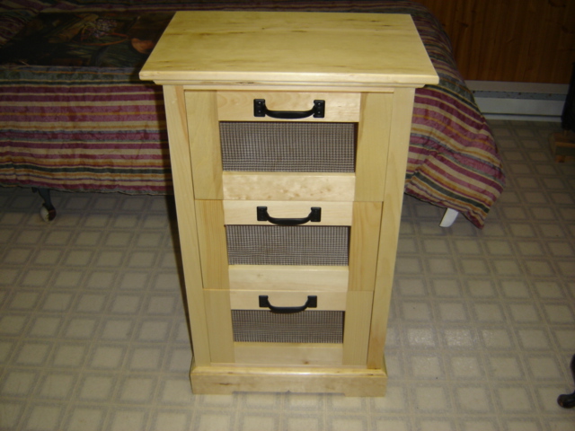

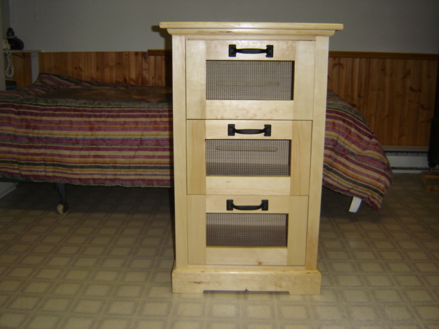

The Harvest Bin is Finished - Well almost!
As indicated above, it's finally finished. The only thing left is to paint the side panels. I thought I would leave the colour to be decided by my daughter if she wants it. Of course this was not entirely my decision as the plans call for the sides to be painted satin black, but powers higher than me said "no way!" Personally I think the black would have set off the natural wood frame and drawers, and top quite nicely, but...
I tried to attach a couple of pictures of the finished bin, and one of an older one. but the news ones supposedly are too large. This is the second time this happens when I have rotated the pictures. I guess I will have to read the posts on how to resize and try again later.:(
You can see the drawers are still a little off in alignment. The suggested handles were more round/oval at the ends and would have looked better, but these were about 1/2 the price. The plans also called for 1/2" screen to be used in the windows but I only had 1/4" on hand so I used it. The 1/2" in the plan picture did make it look a little more classy. Though it dosen't really show in the pictures, the screen is painted black and that adds to the look. All in all it came out not bad considering some of the issues I had to deal with.
One change I did make that dosen't show was to route a shallow 1/4" rabbet behind the windows to receive the wire screen as I don't like leaving any potential sharp points. In previous bins I just added a small piece of trim over the dges of the wire but I thought a rabbet was a better method on this model.

I took some new pictures instead of trying to figure out how to resize the others. The discriptive post wasn't much good with out them.
These aren't quite as good as I had put a dark background behind the originals to help highlight the wood and detail at the bottom. I note I also forgot to take a view with the side showing this time which again helped show the detail.
Still can't understand the others not being accepted. They are the same size, 640 x 480 except I had them rotated to get more hight.:confused:

Thanks John,
Superb project! Really easy on the eyes.
BTW: I have had times when a rotated photo would not post. So I've not rotated any photos for the forums since that time, myself.

I like those bins, John. Looks like something that you could take orders for and sell.
Tim
John - That is one very impressive looking bin! The colors of the natural wood look super! If Daughter wants a color, for decoration, OK it's her bin!!
The pulls you selected look GREAT on the bin!! In fact, probably better than the recommended ones!
The fitting of the drawers looks great! One of the most difficult jobs is to make drawers. It is a big challenge to manufacture a box (drawer) to fit into a predetermined rectangle, while leaving proper space for sliding while not binding or rattling - and all the time getting the fronts to close with a small, but even spacing. This process would have been a mite easier if those manufactured ball bearing slides were used, along with an extra front, applied later. But you weren't offered this option and used the "good old fashioned method". Congratulations! Excellent Job!:D
It also was a very good decision to make the rabbets for the screens. Who would want the rough pointed edges exposed inside the bins?
Great Job, John! Especially with the drawers! You overcame all the issues of the warped plywood to the eye of the beholder.
