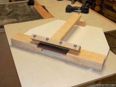

My planer knives need sharpening.
I think I am going to try making a jig like this one I found on ibuildit.ca.
[ATTACH]23862[/ATTACH]
This is the link to the plans Planer / Jointer Knife Sharpening Jig
and this is the link to the YouTube video showing it in use Sharpening Jig
