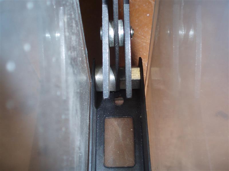

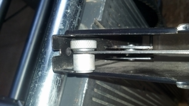

I'm a new owner of a 510. The guy I purchased it from took the upper saw guide apart when I was not looking. I can't figure out how it goes together. I think it expands out. The one side has a shoulder that matches the larger hole. When I expand out I run out of threads before it is full width. There was also a screw but it seems long and if the head is on the outside of the black metal part the clear plastic guard would hit on it.
IMG_20140201_155558_372 (451x800) (361x640).jpg (116.73 KiB) Viewed 1273 times
cantputt wrote:I'm a new owner of a 510. The guy I purchased it from took the upper saw guide apart when I was not looking. I can't figure out how it goes together. I think it expands out. The one side has a shoulder that matches the larger hole. When I expand out I run out of threads before it is full width. There was also a screw but it seems long and if the head is on the outside of the black metal part the clear plastic guard would hit on it.

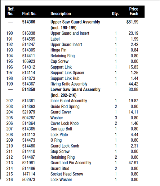

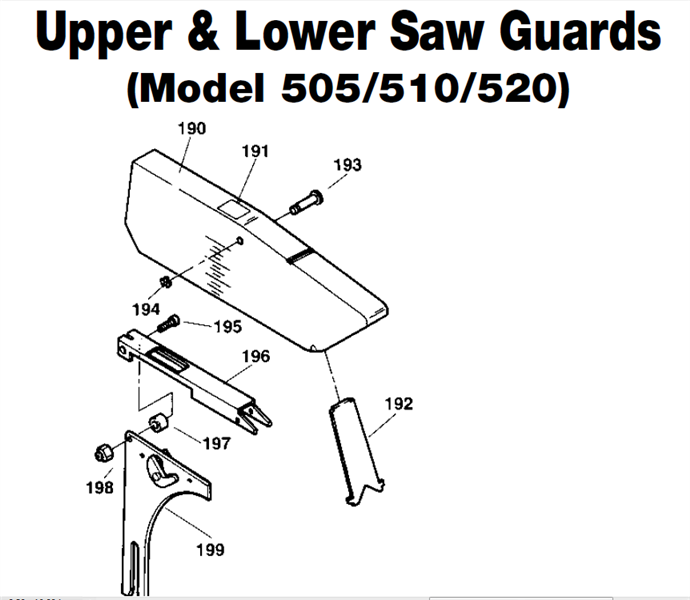

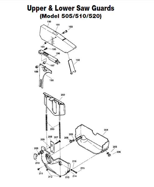

The image of your upper saw guard appears to show a knurled nut where I believe should be a simple spacer.
Hopefully these images will help you.
[ATTACH]23924[/ATTACH]
[ATTACH]23925[/ATTACH]
[ATTACH]23926[/ATTACH]
Capture Upper Saw Guard (Custom).PNG (60.19 KiB) Viewed 1298 times
Capture Upper Saw Guard Page 2 (Custom).PNG (158.02 KiB) Viewed 1302 times
Capture Upper Guard (Custom).PNG (78.33 KiB) Viewed 1301 times

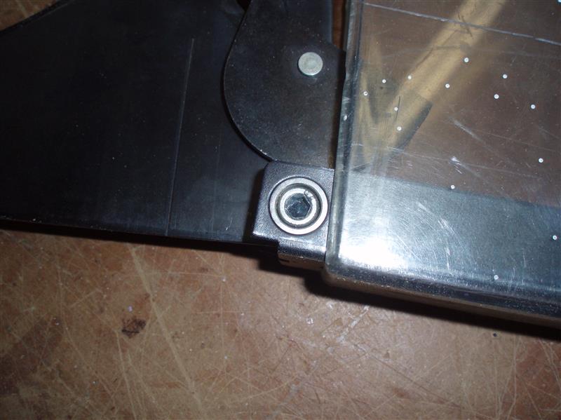

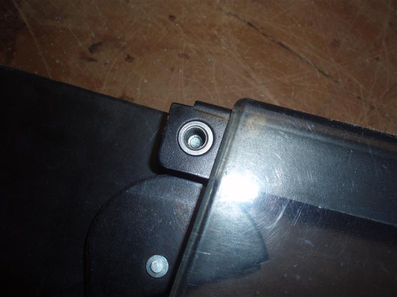

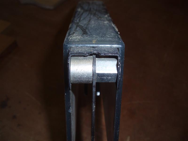

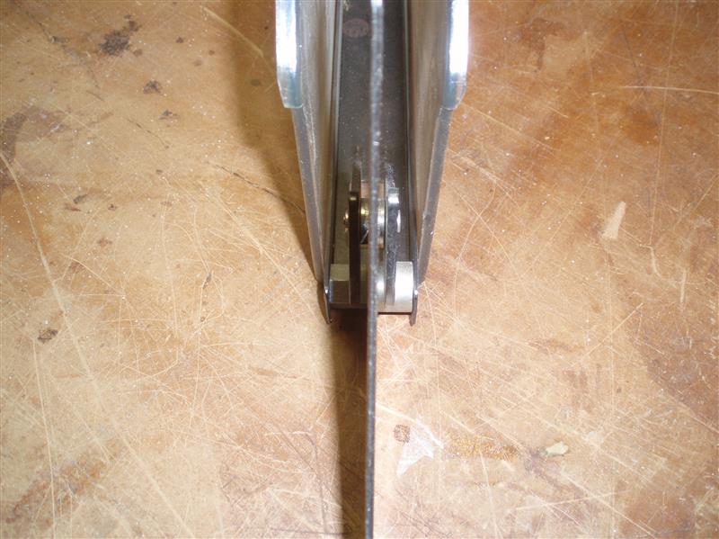

I've taken some photos of my saw guard but upon closer examination I believe mine may be of different vintage. The threaded inserts are what makes me think so.
[ATTACH]23927[/ATTACH]
[ATTACH]23928[/ATTACH]
[ATTACH]23929[/ATTACH]
[ATTACH]23930[/ATTACH]
[ATTACH]23931[/ATTACH]
Upper Saw Guard 002 (Custom).JPG (45.17 KiB) Viewed 1300 times
Upper Saw Guard 003 (Custom).JPG (60.55 KiB) Viewed 1299 times
Upper Saw Guard 004 (Custom).JPG (52.46 KiB) Viewed 1299 times
Upper Saw Guard 006 (Custom).JPG (34.25 KiB) Viewed 1299 times
Upper Saw Guard 008 (Custom).JPG (77.31 KiB) Viewed 1300 times
cantputt
Posts: 26
Joined: Mon Jan 20, 2014 12:35 pm
Post by cantputt »
Thanks, looks like you have that hex piece and I have this knurled part. I'm guessing the knurled part goes to something else and during the move I lost the hex piece.
SDSSmith
Posts: 1940
Location: San Diego, CA
Post by SDSSmith »
cantputt wrote:Thanks, looks like you have that hex piece and I have this knurled part. I'm guessing the knurled part goes to something else and during the move I lost the hex piece.
The knurled part looks like one of the knurled nuts (lock knobs, part 206 in Dusty's part listing) that are used on the lower saw guard to set the width of the guard opening.
